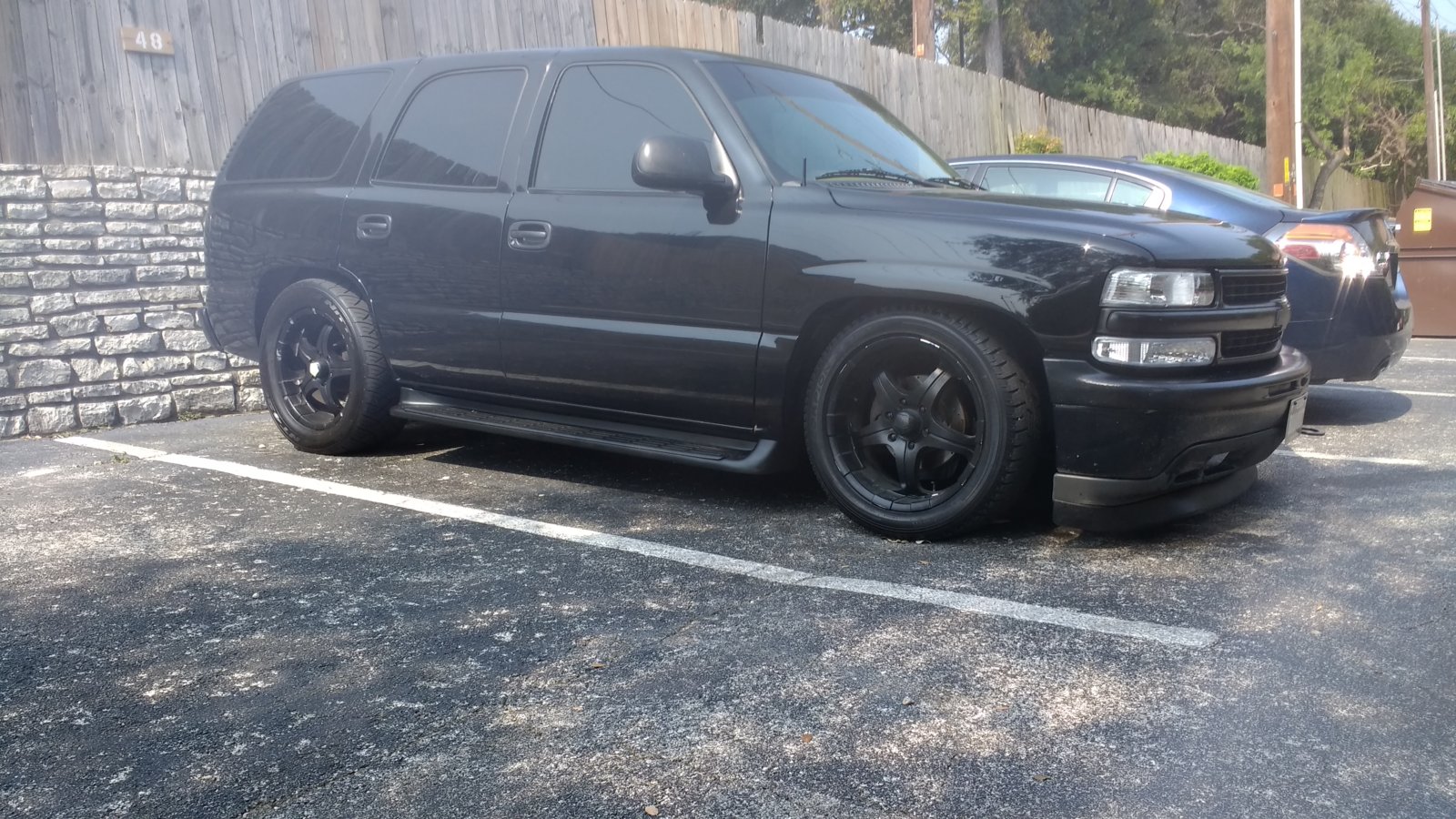

Murderhoe
Aug 27, 2016
If you use spindels then you will need 20" rims or you have to cut the bolts and even then it's very close. I did a 4 4 and have 20" rims. If you use the drop keys then any size will work. IMG_20170906_113206193.jpg
