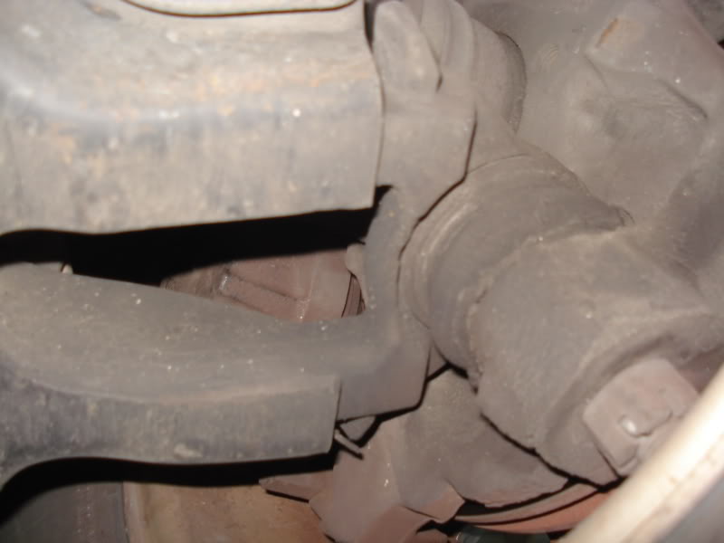

About to attempt to change out all ball joints and tie rod ends as well as idler arm/bracket and pitman arm. Probably going to order my stuff from rockauto. Need to know what size lower ball joint to order. 45.79 mm or 47.89 mm. I have a 1998 2 door tahoe with the 5.7L. Its 4wd with the auto/push button set up. Everything is stock. Thanks for the help!
PS Curious if I should change out the center link that attaches to pitman/idler arms and tie rod ends. Not sure if this parts tends to wear out? Any ideas.

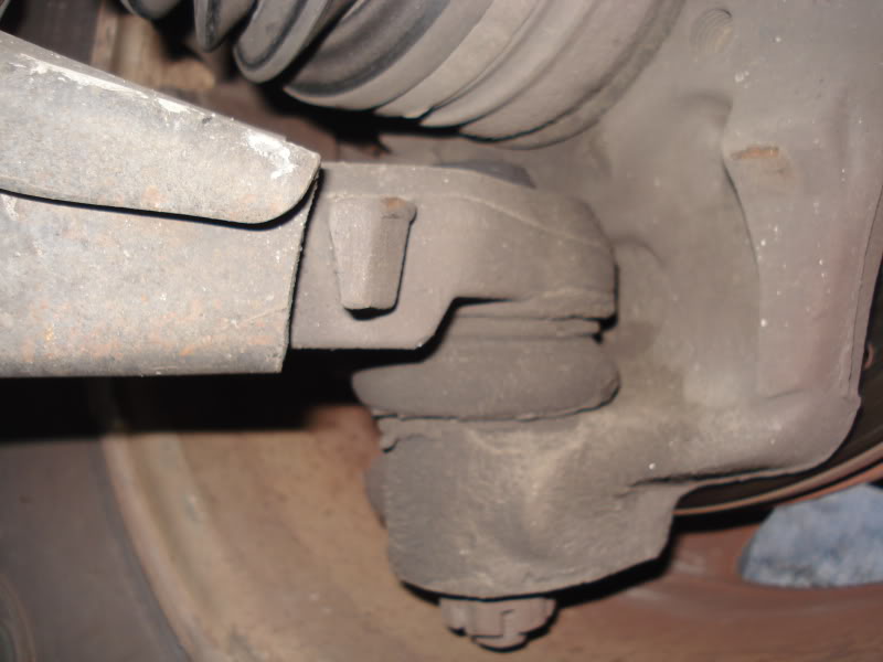

Ok. These look forged to me. What do you think.

unknown at this time.
looks like it. or cast anyway but does not look fully stamped.
---------- Post added at 09:01 PM ---------- Previous post was at 09:00 PM ----------
forged get the 47.89mm joints.
