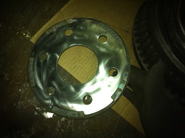

Here you go. Instructions from another forum I'm on.
1) tools you will need hammer , punch, grinder , welder , 6 lug pattern
2) I cut a front rotor from a 06 silverado to get my pattern
3) got the rear drums from napa auto parts
4) welded up the holes for the rear drum justing 3/32" nickel rod keep in mind you have to pre heat this kind I'd metal never put water to koo it down it will crack !
5) grinder the welds down using a 4-1/2" with a 80 grit flap disc
6) place the pattern I had for the 06
Rotor I cut center it with the help
If some calipers
7) then drill it with a 1/4" then checked to see if they where centered right then drill the
Using a 39/64" drill bit. And the back drums are done
8) for the axles it's the same proscess or do what I did and order them from moser and ask them to be drill 6x5 lug pattern
9) for the front I used 3/4 ton rotors napa. P/N 4886915
http://www.gmt400.com/forum/showthread.php?11940-Gonzalez-Kustomz-5lug-to-6-lug-conversion
