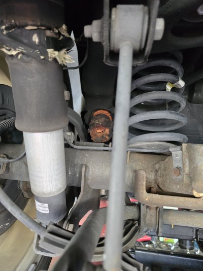

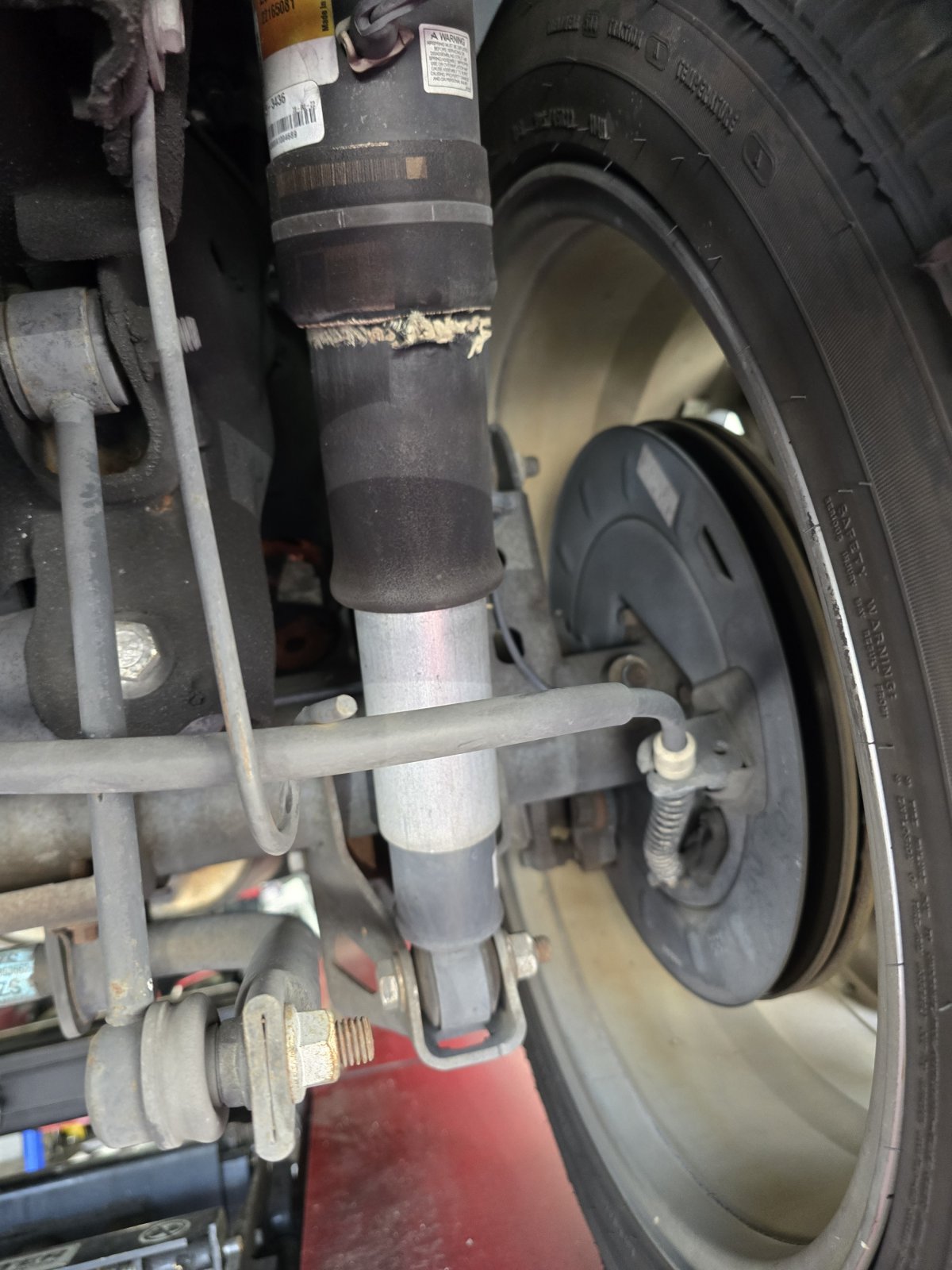

I replaced my Front and Rear Shocks in Dec 2022. Arnott Suspension Air Strut/Shocks MR-3436. They in about 18months. They look pretty bad. Anyone else have this experience? Wondering if there is something else going on before I replace them. They are under a 2 year warranty.

Wow! I have not seen that before, though, other folks with more experience than me may see otherwise. Those look like they were literally blown up.
I wonder if the compressor's internal pressure regulator may have failed, though I don't know if the compressor itself could generate enough pressure on its own to cause that type of damage.

from what I read in a old thread on here. the air fittings blow off before the max bag pressure. I don't know where they got the info or what exactly the psi was without searching again.
that looks crazy.
