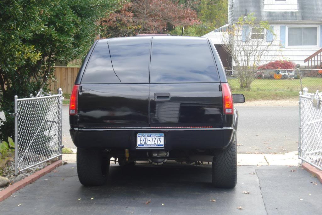

I'm running 305's with none of the modification you listed above and I still have some room. I'll double check for ya if needed.

Hey man, I'll get better pics and measurements for ya today after work.
Here is a pic of the 305's. All I did was remove the helper leaf spring.
