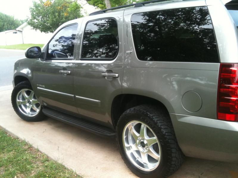

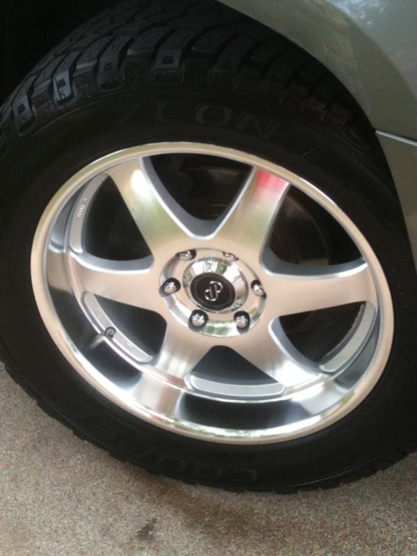

Donovan, thanks for the quick reply. Do you have any pics of your tires? Would be very helpful!
Huge thanks again, this gives me a starting point in terms of what to research. It sounds like the 285/55-20 is going to be my safest bet. Rubbing is a problem given my driving habits and on/off road balance which is a split between hwy, winter passes to the resort and spring/summer camping on old skid roads.

Donovan said:
<img src="http://www.tahoeyukonforum.com/forum/attachment.php?attachmentid=16136"/>
<img src="http://www.tahoeyukonforum.com/forum/attachment.php?attachmentid=16137"/>
Stock size but my wheels are 20x9.5
