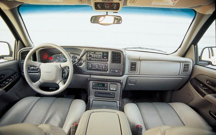

It is actually called the SIC (Secondary Information Center). It was in the console of the 2001-2002 Yukon Denali's, 2002 Escalade/EXT, 2001 Sierra C3 and 2002 Sierra Denali.
It can be wired up to work in your 2001 Tahoe. You can either install the whole denali console or just put the little display elsewhere. Silverado and Avalanche owners often put it in the overhead console where the rear hvac controls would be in the SUV's.
Like this:
Like this:
