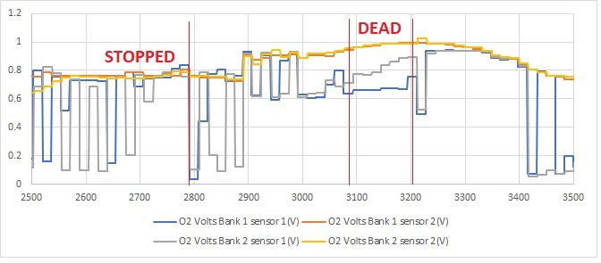

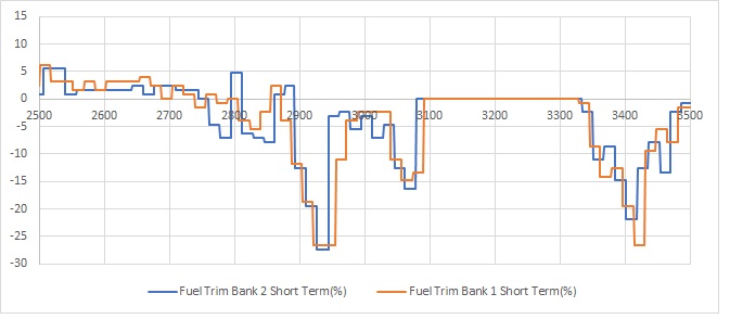

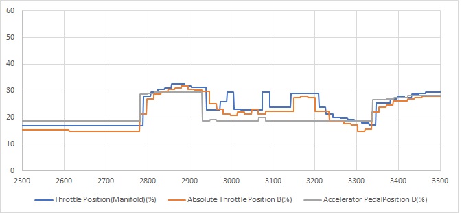

I was able to capture the event this AM that stalled the engine. Attached are a few outputs and i have more data. Any help is appriciated.

In the throttle and pedal graph, I see 2 manifold throttle position spikes immediately preceding the stalling event that isn't matched by the absolute throttle position. I wonder if the throttle body is closing momentarily, uncommanded and causing the stall.
I hate to throw the parts cannon at it but if I had to guess it would be the throttle body. Dorman makes a fine replacement that corrects some of the original design flaws. I've been running one in my '07 for 40K now with no problems.

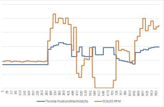

I noticed that too and didnt know enough if TB command was from ECU or faulty.
2010 ESV 105K miles (i should have added)
also superimposed scaled RPM onto TB position for comparison. I just dont know if the TB is commanded to move as a way to regain control or if it is the fault causing the stall.
