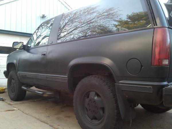

So I thought I should start a thread about my blazer
Its a 1992 K1500
Engine 350 v8 5.7L L05 TBI
Auto Trans 4x4
For starters I bought it from some guy off craigslist not too far away (2hr drive), the guy got over on me real fast (so he thought), i paid $1800 for it. when i bought it everything was awesome besides the muffler and it needed a major tune up. i had checked everything from the oil to the fuel pressure even tire pressure...just for kicks.. and it seemed like everything was normal i drove it back to my city and she rode beautifully besides the loud pipes yelling under me..
so i decide to start on the maintenance while doing so i check the oil once again before i changed it to inspect clarity of it and what do you know.....its milky...
so first thing that came to my mind was either intake or head gaskets since it drove so well.. so i went forward with the intake first (cheaper route)
I started tearing the top end down when i got to the gaskets they were shot so i replace those with fel pro gaskets and ran to the junk yard and got a used intake manifold for 35 bucks (a steal). I cleaned it up real good and painted it black. Looks awesome under the hood.
i then replaced the starter, the Dist. cap and rotor, spark plugs, wires, main ground, radiator hoses, heater hose inlet, pcv, thermosat, water pump, cleaned the maf, knock sensor, o2 sensors, and temp sensor
i still have yet to paint those valve covers.. i also still have to repaint the air filter but other than those few rusty looking parts the top of my engine looks freakin aye...lol
when i first did the tune up after i had completed the intake job it wouldnt start.. i had gotten a few tips from this wonderful site on finding the TDC and that worked out awesomely with a helping hand.
now that i have her running again im thinking its time to work on the exhaust since i never got around to that. I have a single in dual out flowmaster muffler laying in the garage waiting to be installed on something worthy enough.
only thing is i dont have a pipe bender to bend the tail pipes in the direction i want them in. I want them to point out right behind the rear tires i wanted to do in front of the rear tires but i dont know how that would turn out since i have never seen it done on this particular vehicle
but in the meantime in between time i will be also working on the interior
i installed a new headliner in the old one was hung by tacks and i felt like it deserved to be treated better than that i am blacking out everything in and out on the truck when i do get it repainted it will be hot rod black no gloss (murdered out).
If anyone has any ideas to run by me that will be awesome questions are welcomed too but as i go along i will be posting pics and other tips on how i did, what ive done to my big baby
