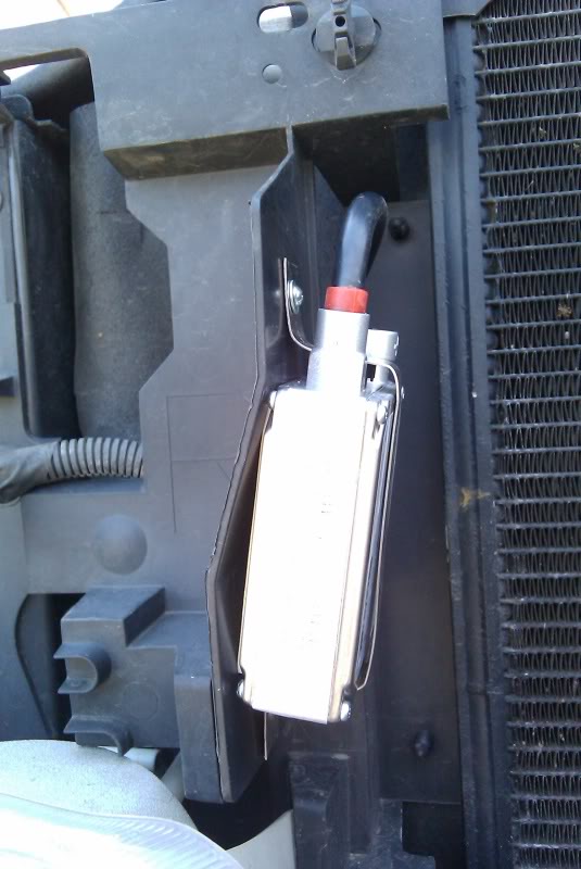

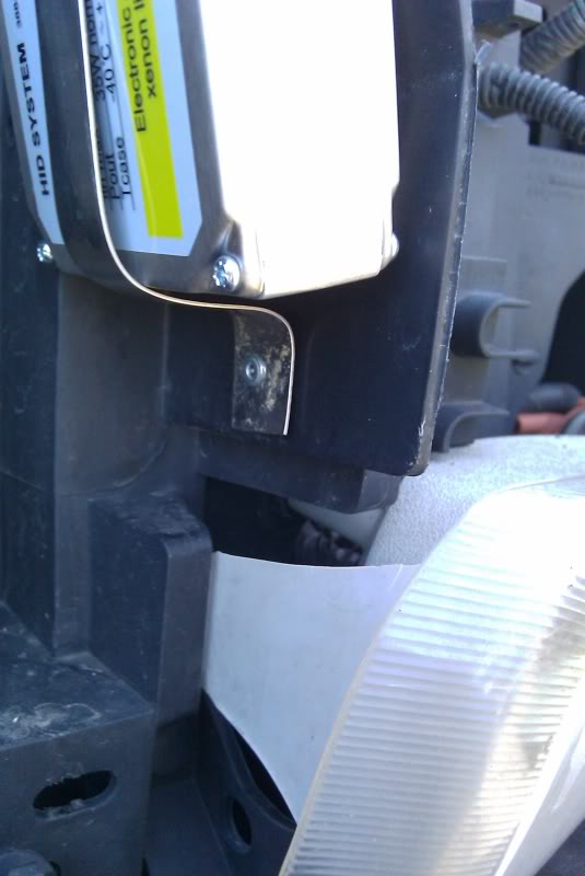

The first thing for me was to figure out where to mount the ballasts. I chose the pretty common place on each side of the radiator next to where the headlights are.

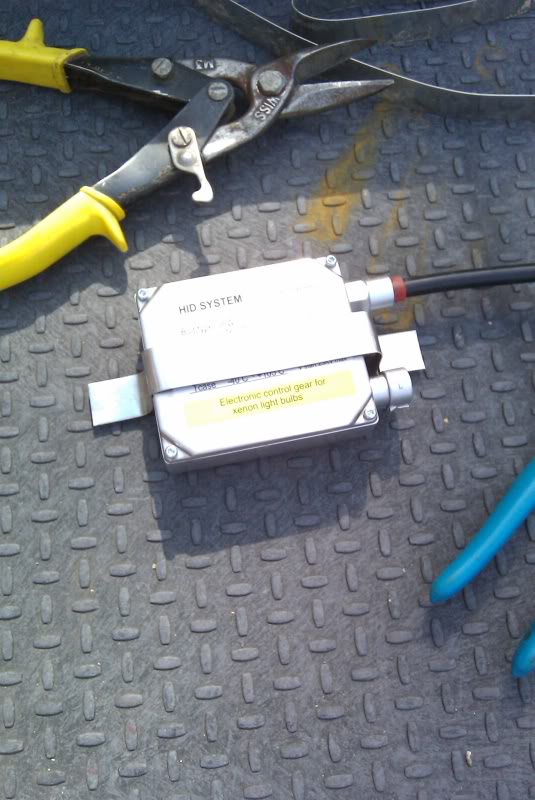

The DDM kit came with some cheap old zip ties, so I decided to use some of this metal banding that I had found awhile back. I think it came out great.
I decided to rivot the bottom of the bracket as seen here:
and then bolt the top, so that it left the ballast sturdy, but removable.
Above was the was the passenger side which I did 2nd and it turned out better than the driver's side as seen below.
Okay, so now the ballasts are mounted and out of the way.

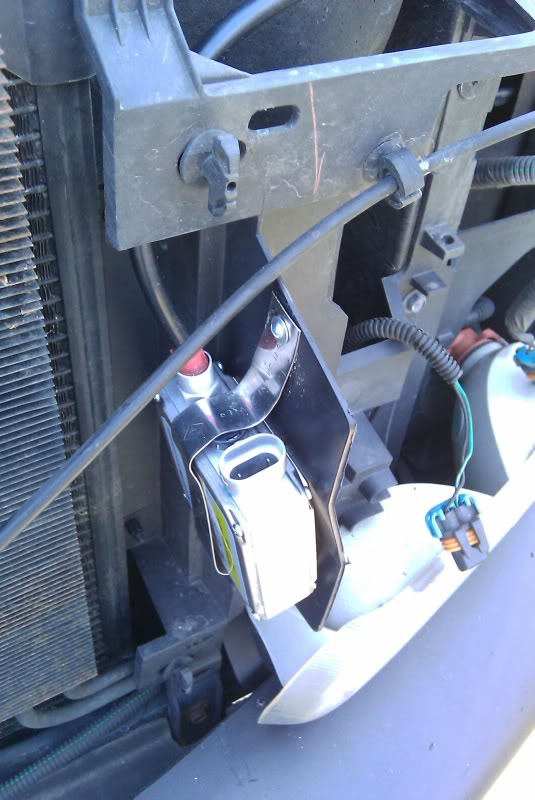

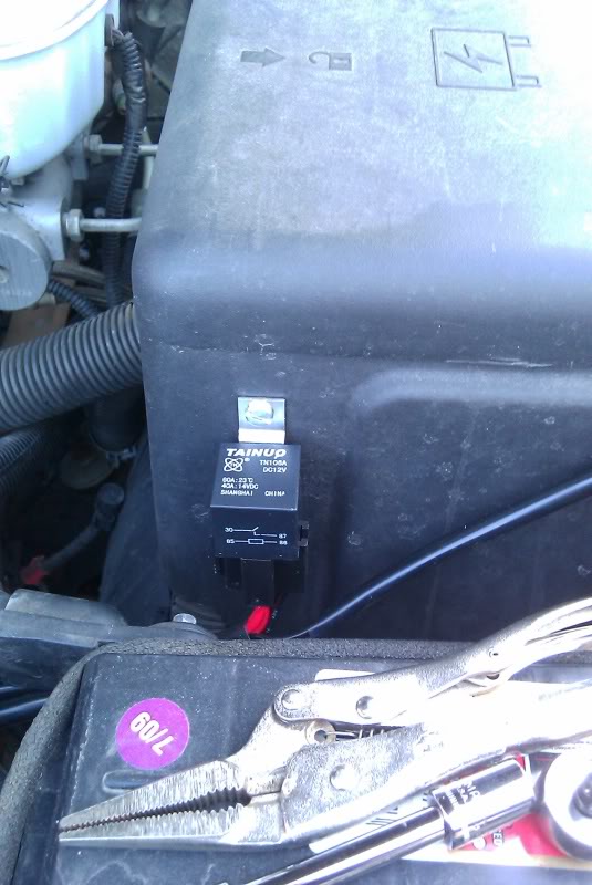

I first tried to mount the relay to the fuse box.
But as I later found out, it didn't leave enough wire to make it to the passenger side headlight. So I decided to move it to the top of the fan shroud. Not the prettiest spot, but i figured it was a good spot that was easily accessible in case it needed to be changed out.

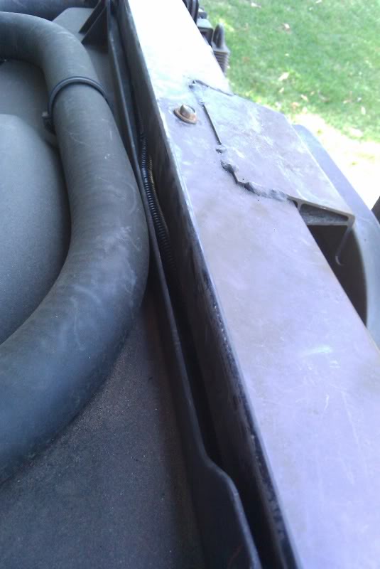

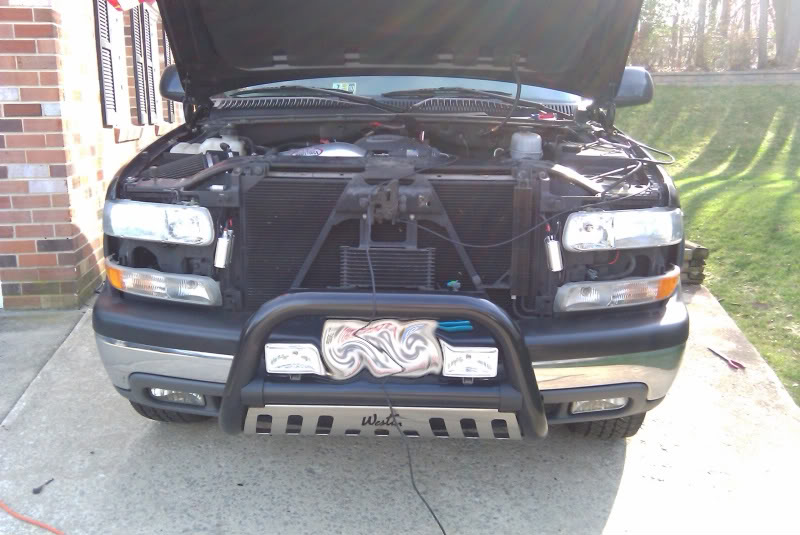

So with that mounted, I then loosened the fan shroud and ran the wire, which I wrapped in some old wire loom I had laying around, underneath the front frame and then tightened the fan shroud back up.
By switching the relay spot and running the wire here, I had just enough wire to reach the passenger side.

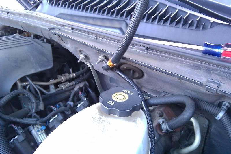

Now for the ground wire out of the relay, I just ran that around the brake cylinder up to the factory ground spot on the firewall.

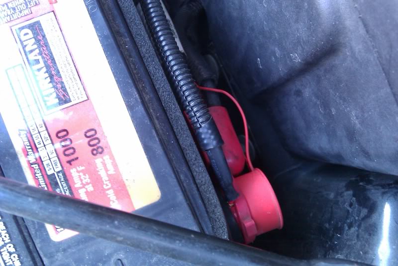

And I hooked up the power wire, it's the one with the inline fuse, to the positive of the battery terminal. It wasn't sitting flush with the wire, so I notched out a little piece of the rubber grommet to allow it sit flat against the battery.
