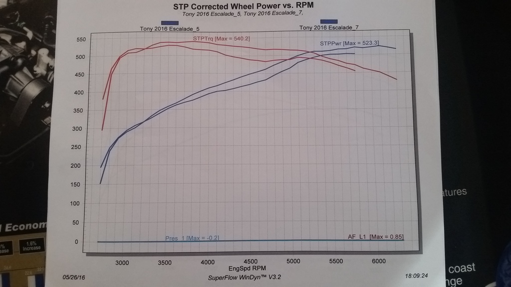

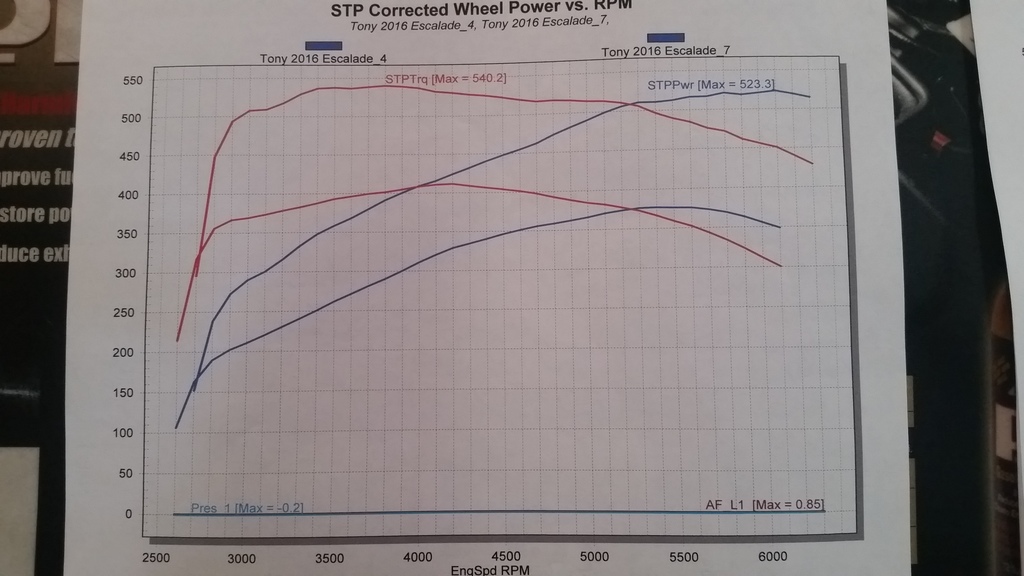

DYNO TIME
91 pump gas
2wd on 26 inch rims.
Top pic is dyno of canned whipple tune vs my buddys tune from matt @gptuning. You can see nice increase of power over across entire curve.
Bottom is gptuning tune vs preblower numbers. I did have afe intake and 3.5 cat back MagnaFlow on pre blower install.
523 rwhp/540 rwtq and vs pre blower pass some parts of power band have over 170 rwhp more and 160 foot pounds torque. Next mod is ARH headers with non catted y pipe. Also it was 74 degrees in shop vs 63 degrees on pre blower dyno.
Overall very happy with the whipple numbers. Going to the track next week. I want to run 12.50s on 26" rims.

As I said in your "Build Thread"...Impressive !! Especially on 91 !!
