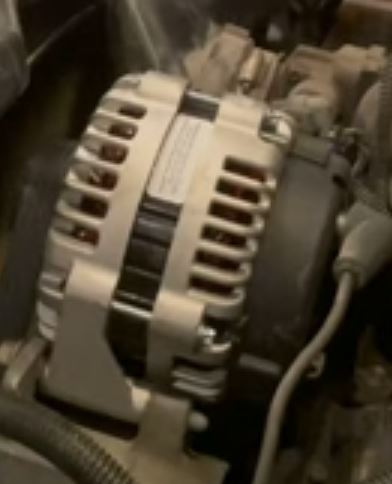

Thanks for the input. I just spun the fan with the belt on and then took the belt off and spun again. I tried wiggling the fan and it’s pulley and don’t feel any play. I also can’t get it to make any noise.
I spun and wiggled the alternator, power steering pump, and idler pulleys. The only one that makes any noise is the idler pulley. Here’s a video:
The water pump [Eastern] and alternator [AC Delco] both have less than 2000 miles on them. The truck itself has 210k miles.
I don’t know if the fan clutch has ever been replaced....

You might not be able to spin it fast enough. Also, the fan has a thermal clutch so its engagement will vary with temperature. By the time you got to messing with it, it could've cooled enough to lose pretty much all drag, making the sound impossible to replicate.
Your first post suggests that there's two separate noises you're hearing. I could only hear the noise at the end with the engine shut off and the fan slowing down. I'm 100% convinced that one, if not all of the noises you're hearing is related to the fan clutch. Idler pulley slack and noise is somewhat normal, but yours sounds a bit excessive. It would be a cheap start to fixing the possible other noise as well as good preventative maintenance.
Also, aftermarket water pumps for these things don't have a very strong track record. They seem to last just past their warranty period with normal, daily use. So, it's sure to surpass the warranty period if you don't drive much. Of course, this means it'll fail on your first road trip.

That idler pulley is bad and while apart, I would do the fan clutch, especially since you think it is original. That idler is under way more stress and will be noisier under load than with the hand. If you have the money, while it is apart, do the tensioner as well. Hell do all of them and belts too. I love spending OPM!

I hear you on the road trip comment.... Amazing how that works!
Regarding the second noise, I can’t get it to come through on video unfortunately. It started at the exact same time as the first noise, so I assume they’re related. Looks like a tensioner/pulley and fan clutch replacement are in my near future....

Thanks, I’ll be replacing the fan clutch and tensioner/pulley. But will have to stop there for now! Haha
