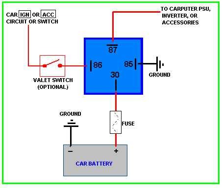

we is there anyway you can write/draw how to wire up a relay?
08grey
Jun 17, 2012
4,596
725
86 is your remote wire
30 is the hot from the cig
87 goes to the headrests.
Ground is shared
