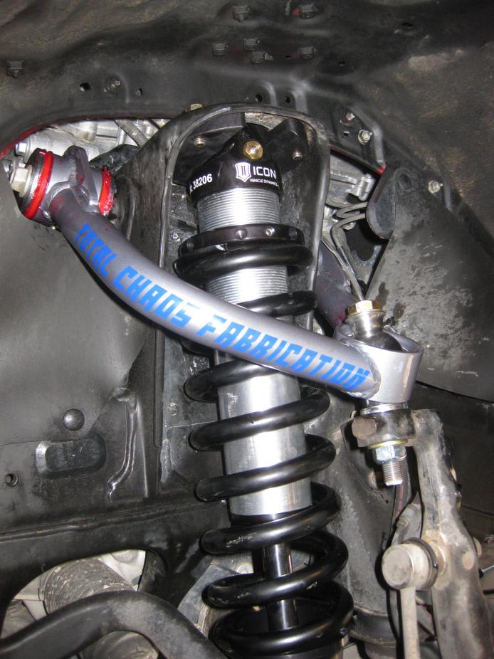

This would be cool to see, but I have not seen this on any of the Tahoe/Yukon forums. Try the GM fullsize forum for review on trucks.
IMO having seen this done for other trucks, the front fenders will need to be trimmed or have custom fenders made especially when getting wider tires. Not sure if Silverado fiberglass pre-runner type fenders will fit. Hopefully the upper control arms are the uniball type to take advantage of the extended travel and prevent suspension binding.
Either way, the Fox setup should provide a better ride on and off-road. Just curious, is this for looks or do you actually wheel it in rough/fast off-road conditions? I have ICONs on my FJ and the ride is much better in all driving conditions. Corners more flatty on road, and plush off-road. Cannot be beat coil overs :driver:.
Here's a pic of the coil overs and UCAs on my FJ.
Hopefully you get this done and can post some pics.
