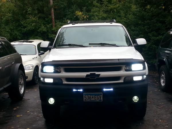

The turn signal/parking light are the same bulb (3157) and you will need a resistor for each of them. The side marker is a 194 and you do not need a resistor for it. When the turn signal is activated, the parking light will blink alternating with the side marker. Here is a picture of my HID/LED set-up. I am using switchback 120 SMD LED's for the parking light/turn signal and white 194's for the side marker:
