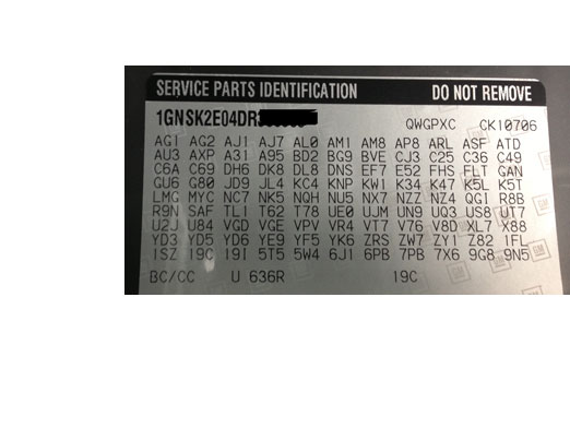

It has both the switch with "AUTO" and the 'bubble' in the center of the dash - this is a true Dept. issued SSV; RPO codes attached.
Do you think they can program just the AUTO part and leave the DRL disabled?
What will a dealer charge to do this?
The daytime running lights can be disabled simply by pulling the fuse.... if it has a fuse for the DRL.
I would think a dealer would charge $75 to $100.... if they can do what you want.
Suprised to see the civilian dash and switch in place with the 9G8 code. Pretty uncommon but hey, it's saving you a bunch of hassle. The dealership should be able to enable the autolamp feature with a Tech II, provided the sensor is actually there underneath the bubble. They can probably leave the DRL's disabled too if that's what you're after.
The dealer is telling me this is not a setting they can change this with the Tech II, they won't even hook up and try for me. Does anyone know if they are full of crap?
