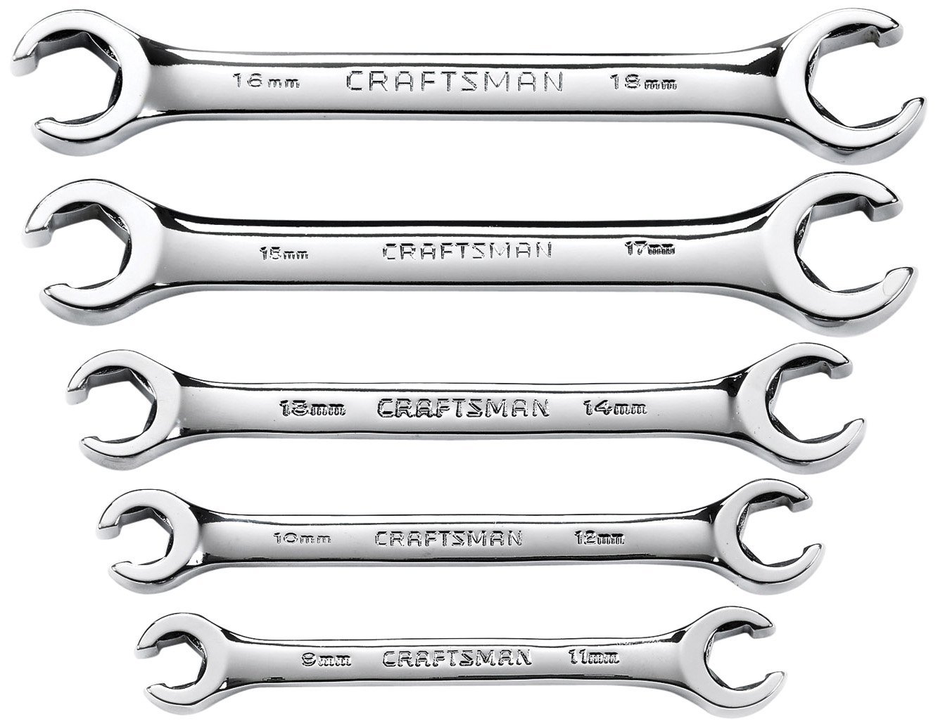

I've had the best luck on all of my cars bleeders using line wrenches, they wrap around the bleeder a little better. I discovered that after breaking 2 off of my wifes jetta right after we first go married. (Her first introduction to hearing profanities being yelled in the garage while she was inside the house...) I won't touch a bleeder now without a line wrench
*Also known as a flare nut wrench I believe.View attachment 195698
This. Flare wrench fo sho. Like @Galante said too. If they're that tight, put kroil on there and give it a bit. Just worry about getting them out without breaking them and plan on replacing them.
Yes but if they are that rusty that wrench is just gonna spin...more than likely he will break one but ive gotten lucky on a few occasions...vise grips since they are toast anyway.... you know how it is since you experienced it first hand..;)

Are these metric or standard sizes? Trying to figure out which flare wrenches to get.
