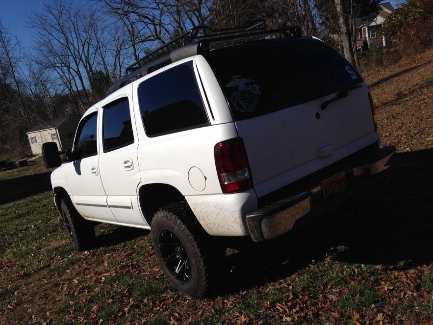

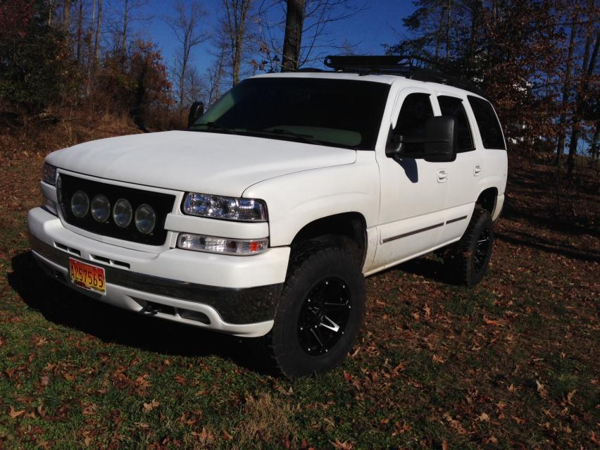

I have 33s on 17s 0 offset with that lift plus a 1.5 body lift. The tires barely stick out of the fenders so a -12 offset should stick out 12 more mm's. It barely rubbed without the body lift, just had to cut a little of the liner out and round the corners of the lower valence.

Front and Back 17x9 0 offset 33 BFG AT

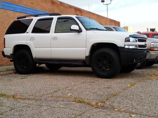

305x55/R20, -12offset (33.21 inches)
No lift, cranked the torsion bars about 1/2-3/4", and used a sheet medal blade and BFH to trim the rear of the front wheel weels/front of the running boards, and a slight trim to the plastic on the inside of the front bumper.

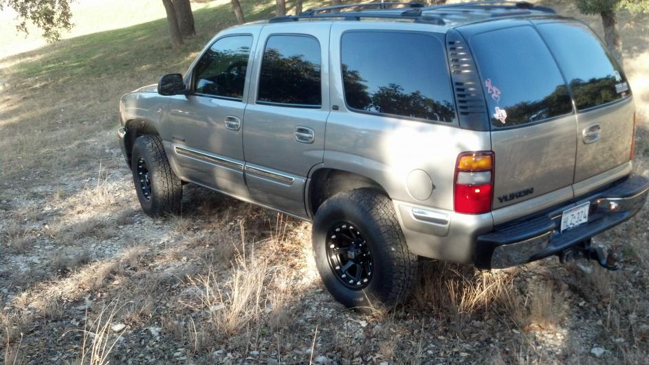

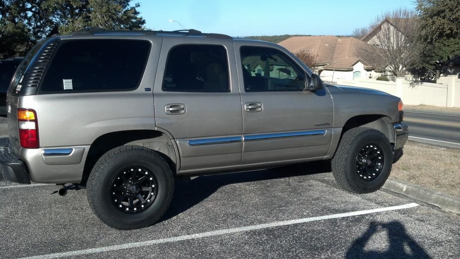

I did the 2.5" up front and 1.5" spacer in back. Wheels I put on were 17x9 addicts, not sure bout the offset. 33" tire. I know that if you get 12.5" wheels theyre gonna stick out a whole lot, not sure if that's what you're looking for or not. Going from a stock wheel to a 17x9 for me, it stuck the tires out maybe half an inch to an inch from the wheel well. It looks pretty good to me, but imo the 12.5" on my rig would look stupid. All my opinion :) Oh, and my car actually sits higher in person than the pictures show. And I could not run a larger tire on my setup, the BFG's rub when the steering is all the way locked one direction or another.
