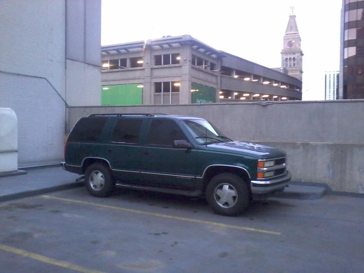

Update
As requested, update:
Pic of the new truck.
I tested the defrost functions. The rear defrost works. The left back only does half, so one of the connectors probably isn't seated right.
The left mirror gets warm. The right mirror gets warm.
The indicators don't come on the mirrors themselves.
I have to get my ohm meter today.
