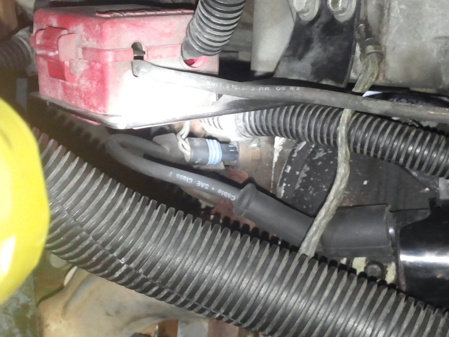

So i get home and take a closer look and find this! it was hissing and definitely not right. Isn't this the fuel pressure regulator?

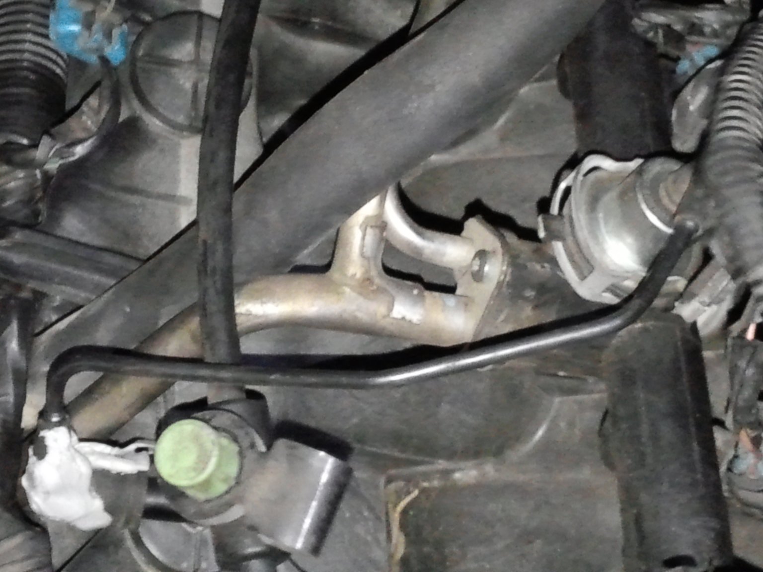

Can somebody tell me what this plug is? it's right in front of the first spark plug and the engine quits if you take it off . I'm pretty sure that this setup ain't right.
