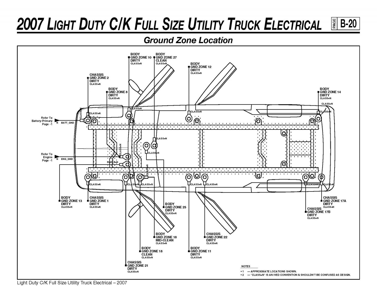

Battery connections cleaned recently? If not try those including your ground connections...
I just replaced the battery about a month ago and everything looked fine. What do you mean by included my ground connection?
Your ground connections around the frame. You can probably find a schematic if you Google it.
2006yukonDenali
Sep 30, 2020
20
Here’s for my ‘07 as an example...
They're all good. Im the 12v constant to the starter is good, but when it turned the keys there is not ignition power to it. The problem lies somewhere between the key and the starter
Edit, just checked, there is power going to the crank fuse in the fuse box and the relay is working properly
