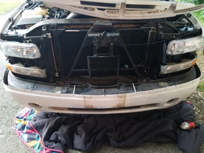

It's the engine oil cooling lines I'm wondering about. I've got the towing package, which equips the truck with the auxiliary transmission oil cooler on the front of the radiator to deal with the extra load on the tranny during towing. But I don't have engine oil cooling lines. Trying to figure out why some cool the engine oil and others don't.
