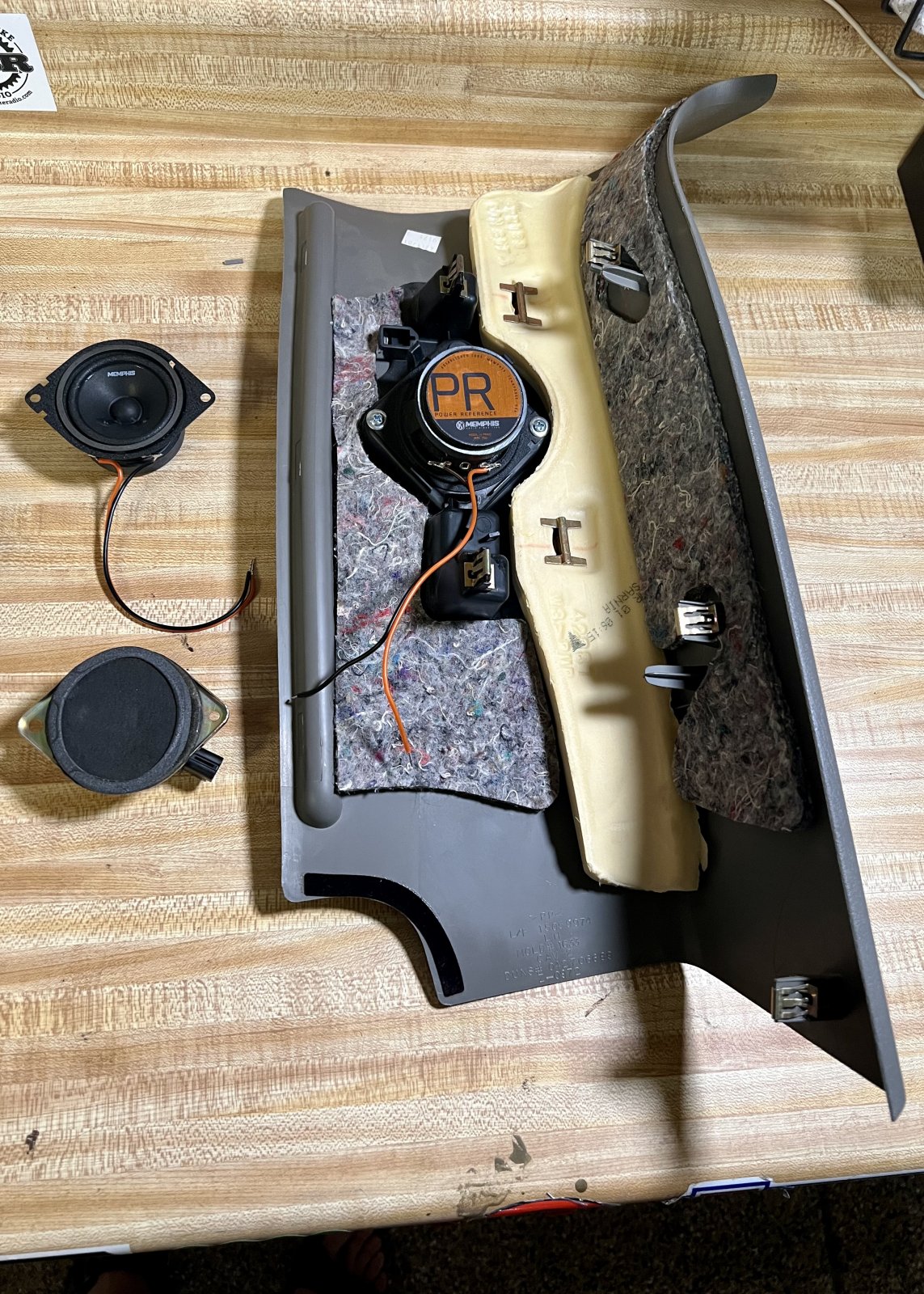

My experience from installation on my 2001 Yukon -
The signal to the front door teeeter is already a high-pass/low-block signal, so ou don’t need crossovers in the front door. You can use any tweeter in place of the OEM tweeter. I plan to use Polk Audio DB1001
tweeters mounted to Metra 82-3016 adapters, but this adapter is just a thin double-teardrop shaped plastic trim panel. You could just as easily use band strapping.
The OEM speaker in the rear pillar is a full range speaker, not a tweeter. I don’t know if it receives a high-pass / low block signal from the amplifier, so I installed a Crutchfield high-pass 150hz capacitor with a Memphis Audio PR27 full range speaker. The FR on the Memphis PR27 is rated at 200hz - 12,000 hz …. Not very wide at all, but I was pleased with the fullness of sound it provided. I’m getting plenty of higher frequency treble from the door tweeters. I tried three other speakers before I found the PR27 that fit cleanly in the rear pillar bracket. I rotated the Memphis 90 degrees and used two small sheet metal screws on the side of the speaker frame, plus re-used the existing top pressfit pin to secure the speaker in place, per photo.
