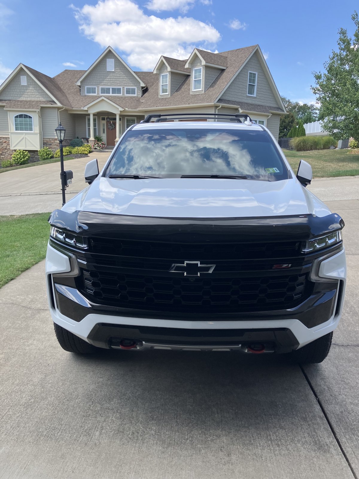

Recently added Borla touring system to new 2024 5.3 Tahoe z71 - big mistake- gas mileage has declined- and noise level way higher than expected- had added K&N air filter some time before adding Borla - everything ran well - but adding the Borla threw everything into tailspin- Can’t say Borla has been any help - thinking of adding resonators to system but don’t know if that will be of help - anyone out there been down similar road - really like my Tahoe but Borla changed everything

Pics of the truck, please.
