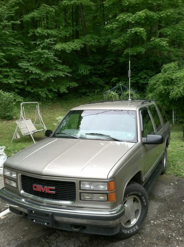

Good day to you all, I'm here in upstate NY staying with my daughter + four kids while her husband is deployed. I'm an appliance technician (taking some time off) so I have mechanical abilities just never got into working on vehicles.
The AC will not come on. The AC button lights up. All the fuses are ok. The compressor is not coming on. As far as I can deduct it's not getting any power to it. I pulled the connector off of the low pressure switch and ran a jumper across those two wires, did the same on the high pressure switch. I didn't know if say it was low of refrigerant, with the LPS jumpered that it would come on right away? I didn't leave it jumpered long mostly because I'm just not sure how it all works. Plus it's not my rig and I didn't want to be the cause of creating additional issues.
I look forward to any tips on how to properly diagnose this thing. It's beginning to get warm here in Upstate. Thanks very much!
