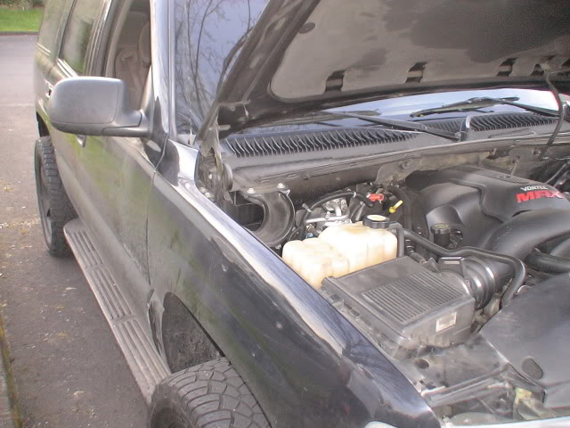

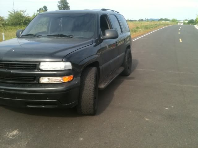

well, I have had the truck since back in 08, but it has evolved to what it is today, how I would want it built. She has had alot of work done to her and is still undergoing more changes. Its been lowered, lifted, leveled, then back lowered with a 2/4 belltech drop. It rolls on SS Matte Black 20s, wraped with 305/50/20s. Tint is 2.5% all around with 35% windsheild. Under the hood and drivetrain is where its not the ordinary.
06 6.0-VMAX engine, 07 4l80e 1 ton tranny, 4000rpm 9.5" stall converter, 4.88s gears, Airaid intake, LPP 1 3/4 longtube headers, 3" catless ORY into 4" Magnaflow dumped, Street tuned, and a bunch of other small nicknacks Im forgetting to add. This Xmas should have a D1 Procharger on it.
This is how she sits, but Ive decided to remove the roof rack this week, and lower the front some more, and get rid of slight rubbing.

yep with LSD, and about to get the Spohn 00-06 Fully Adjustable Rear Bar kit from Tony here shortly. Its a street truck. Tires measure out to be 32 inches
