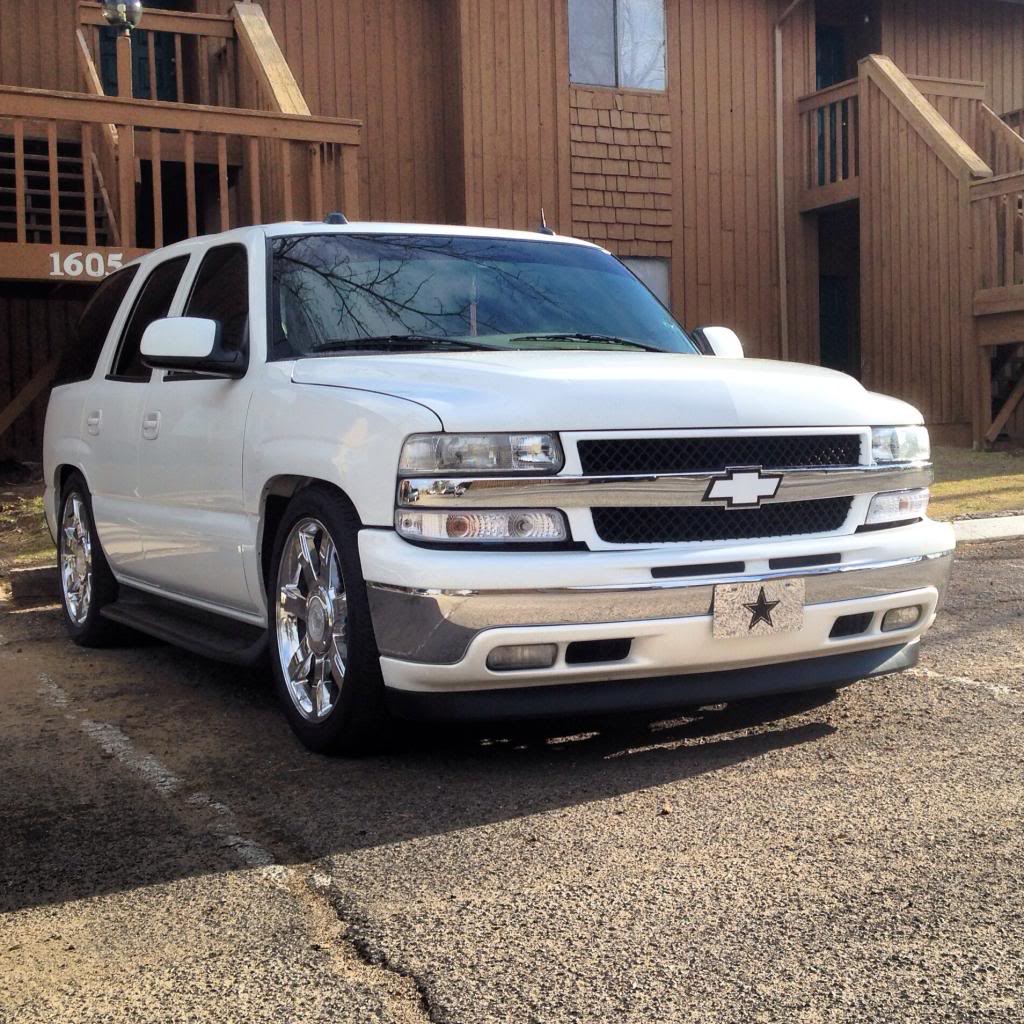

Cody painted his grill the way I feel it should be. Just do it. I'm going to start gathering up the parts for it.

Sorry neverstisfied did it on his just trimmed the bottom of the grill and kept the reg top cover for the bumper

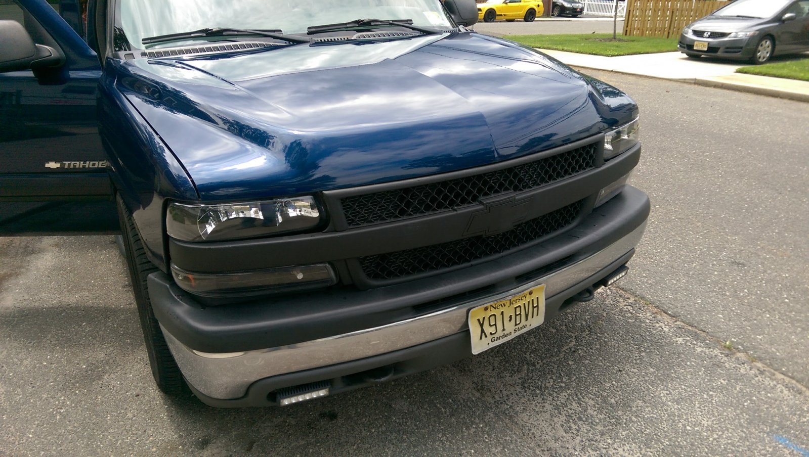

We've already talked about it all but for anyone else wanting to know I just took off about and 1" from the bottom of the grille which will put it just slightly above the stock bumper pad. Enough to maybe for a couple pieces of paper under it lol. I still have the HD bumper pad In storage and may still do the whole conversion but as of now I really like how it turned out
The grille is actually wrapped and not painted lol work at a graphics shop and thought I would give it a shot

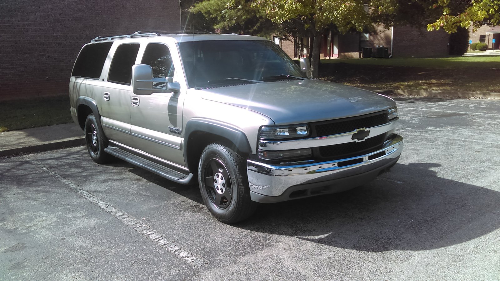

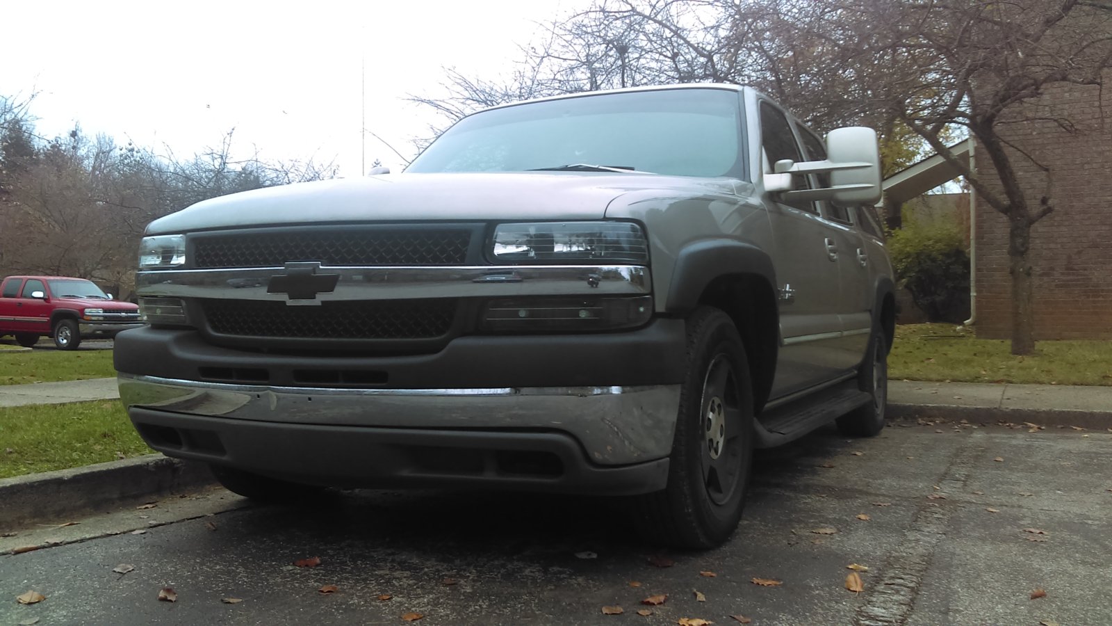

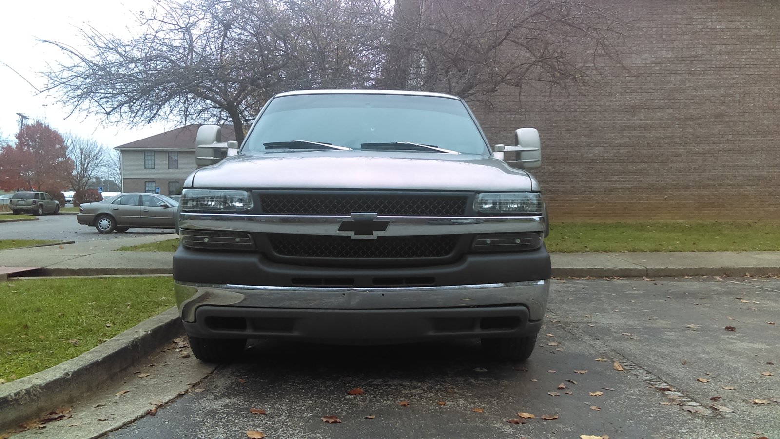

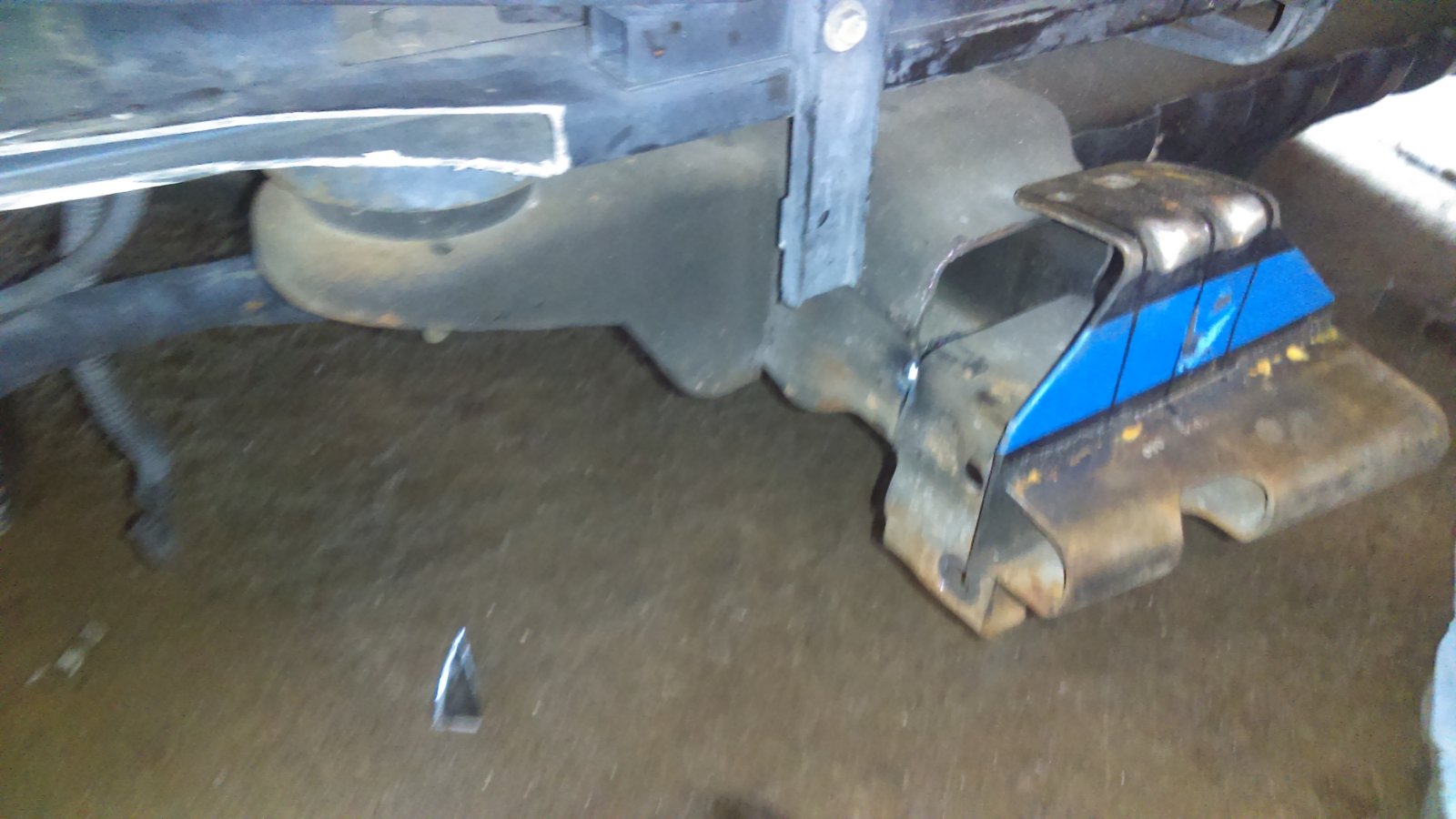

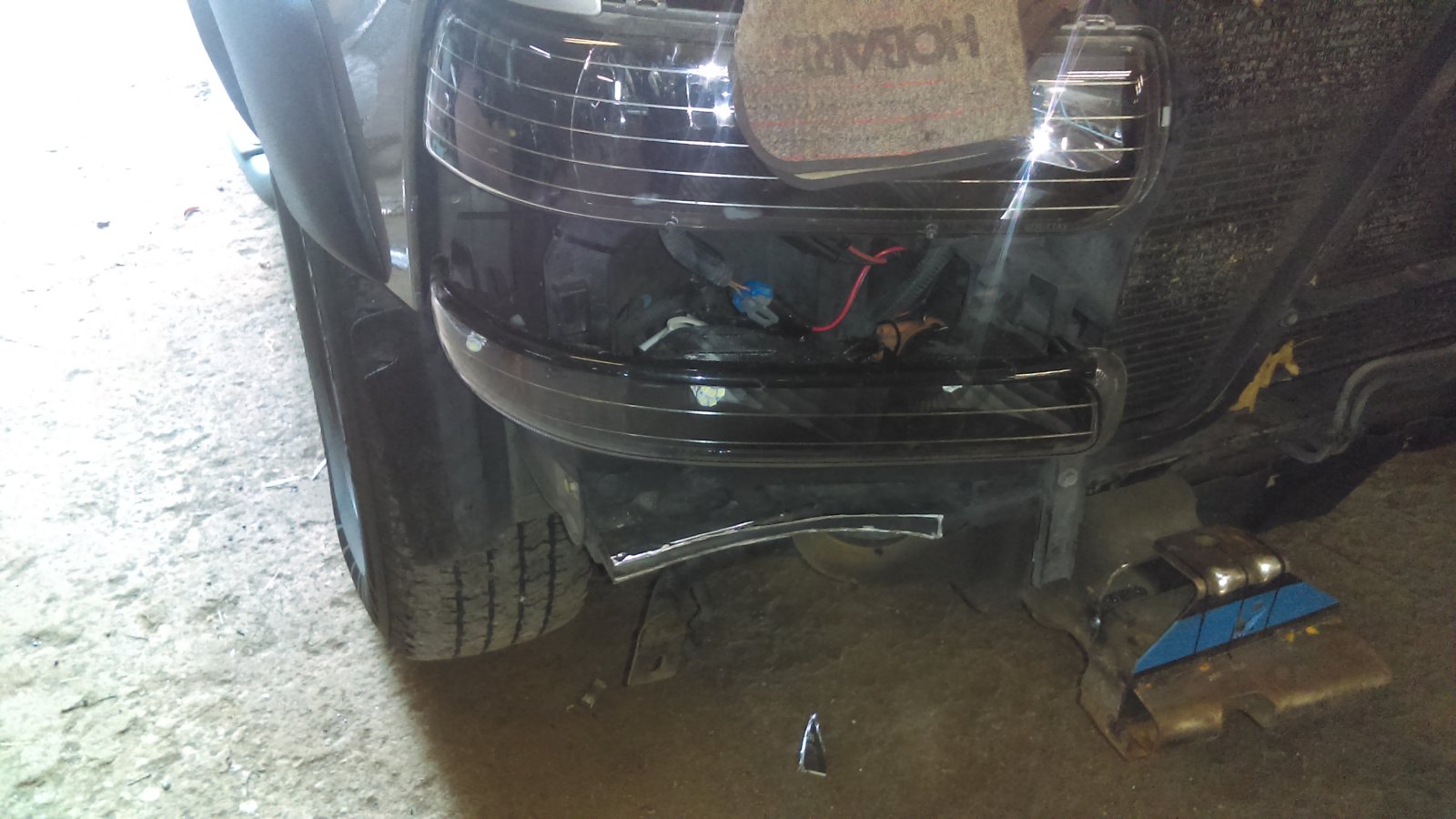

Heres some pics i was goin to cut the brackets then i change my mind i decided to cut the horn Frame that way the mounting brackets would stay lined up with bottom ones if i did it the other way the holes on the mounting bracket wouldnt line up then i have to get spacers for the bottom Brakets then drill new holes and shorter upper bolts Other than that it came up nice ;)

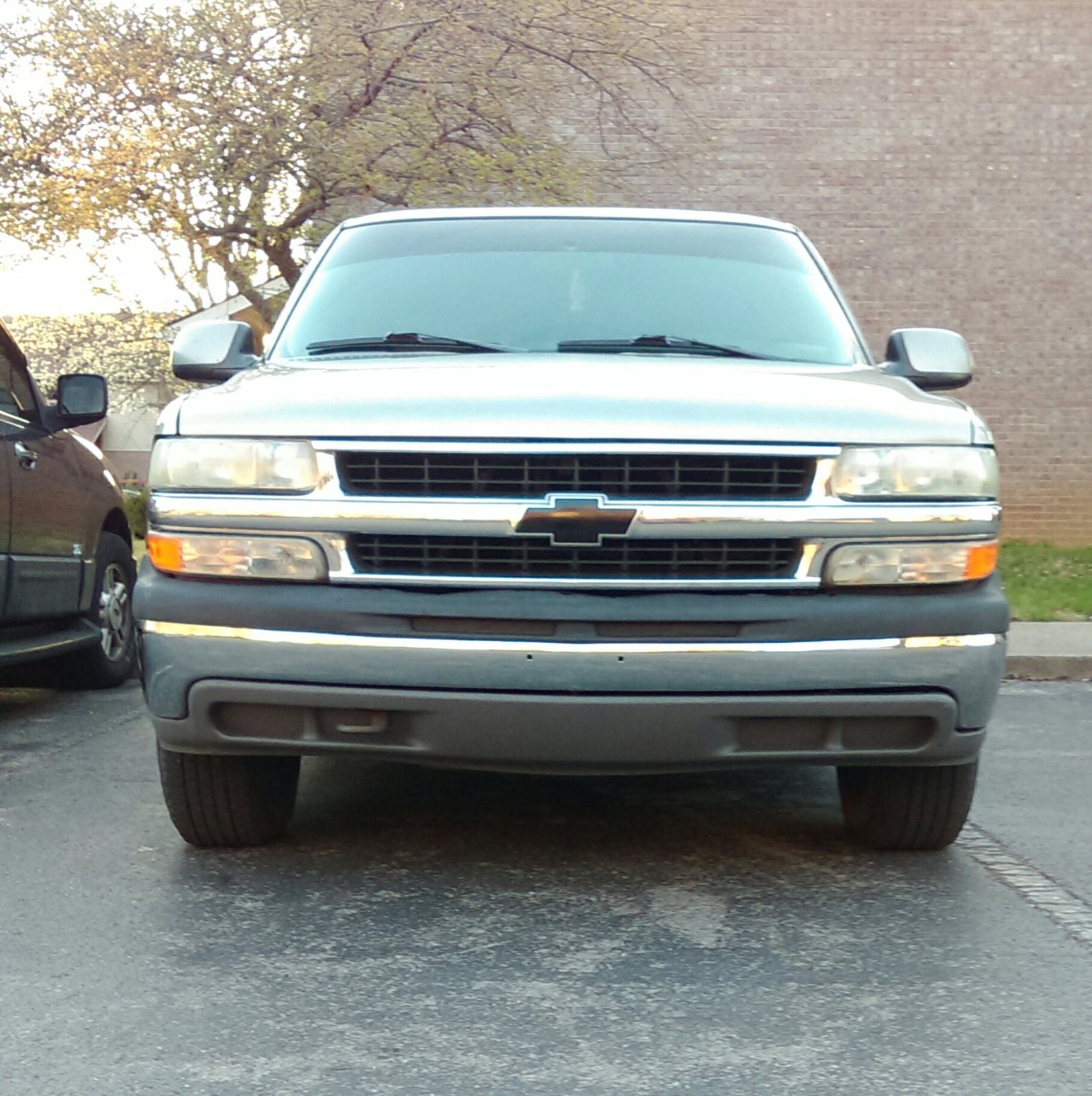

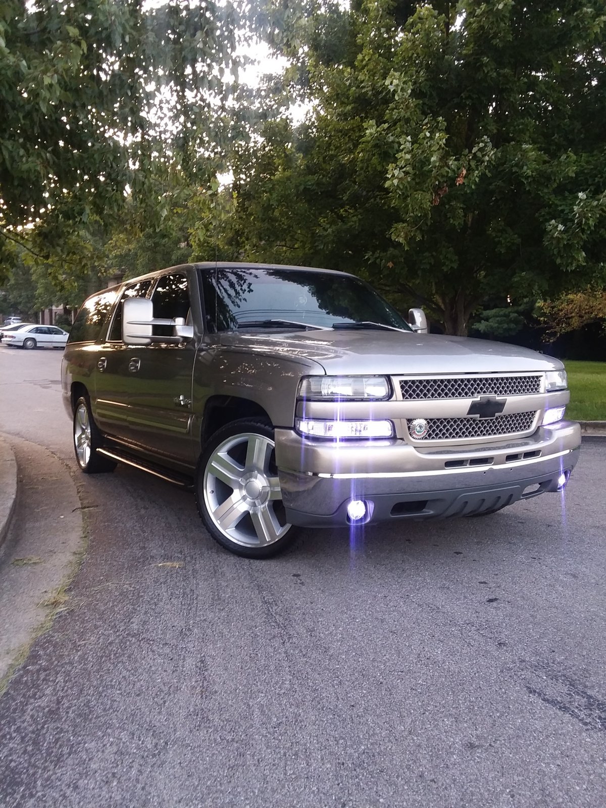

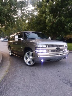

I still like it i had my hd grill bout a moth or two before i took it to a shop to get it done heres a pic of mine couple weeks ago

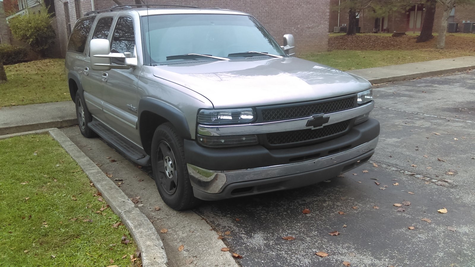

Got my hd conversion done last week Now Im Just Missing The Hood Lol
