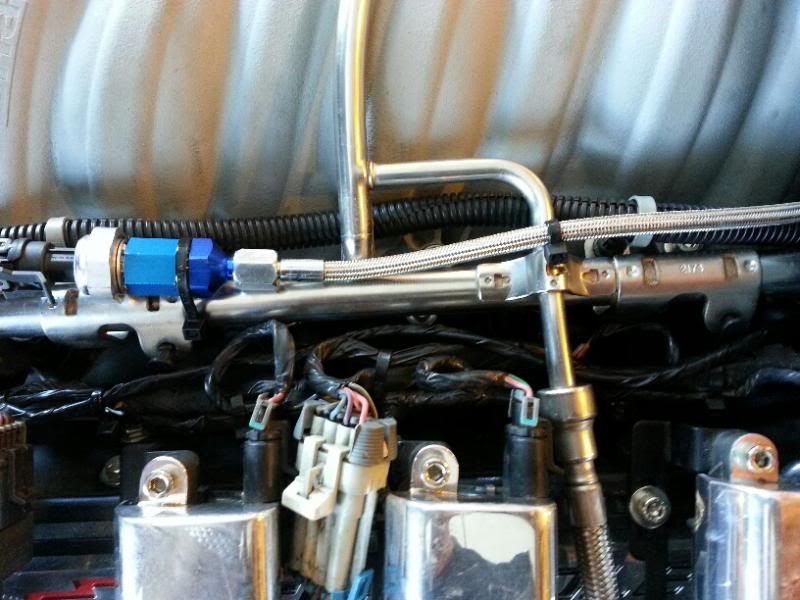

95% probability it's the sending unit. It's a common LS problem. It happened on my Z06 and I relocated the sensor in case of a subsequent failure (has happened numerous times). Jegs had everything I needed for the relocation for 15 bucks.
