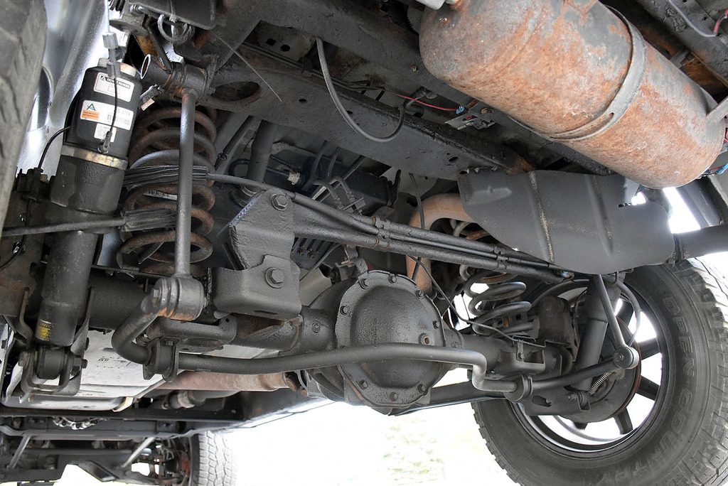

Parking Brake cable ReRoute above the axle?

Anybody done this with some pics and how to best disconnect the cables to run them above the axle instead of slung underneath?

Don't need to loosen anything just use some pliers or vice grips to pull the cable forward. Once you get one disconnected the other doesn't need to be pulled. Same way going back together need to drop one in then pull the other to get through hole. Here's a pic of cables routed on top of axle (not my lift or why he ran one cable through the coil spring but for example)
