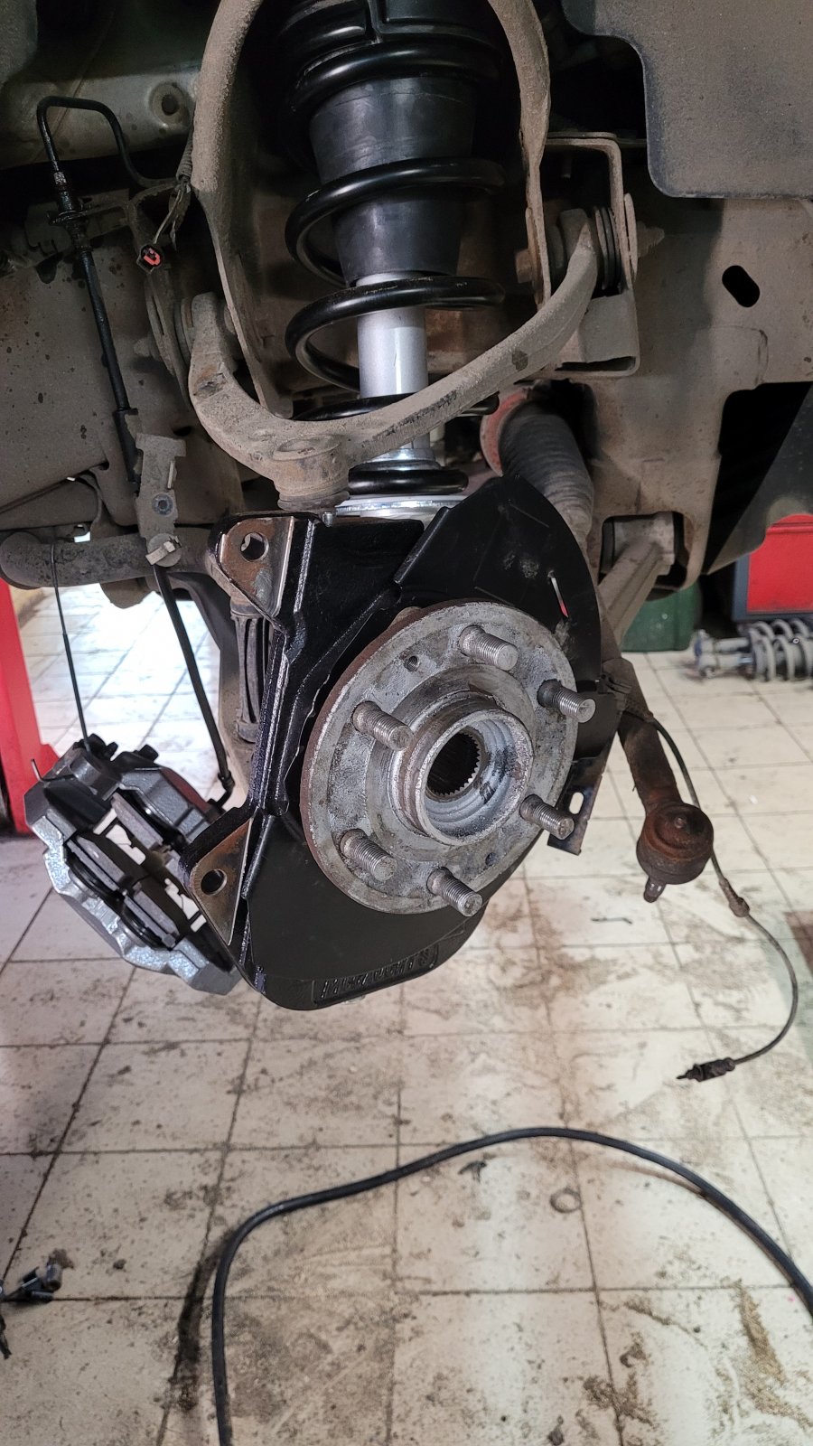

Hi all,
What is the correct part number for McGaughy's 2" drop spindles for my 14 Tahoe PPV. want to make sure I get the correct ones. is it 34200?
DesertfoxAZ
DesertfoxAZ
Mar 20, 2025
21
37
so, looking on their sight, 07-13 use part number 34037 and 14-20 use part number 34200
I thought 07-14 where all the same.
DesertfoxAZ
DesertfoxAZ
Mar 20, 2025
21
37
Was on the phone with them today. It was based on which lower control arm I have. Aluminum, so 34200 was the number of anyone needs it.
