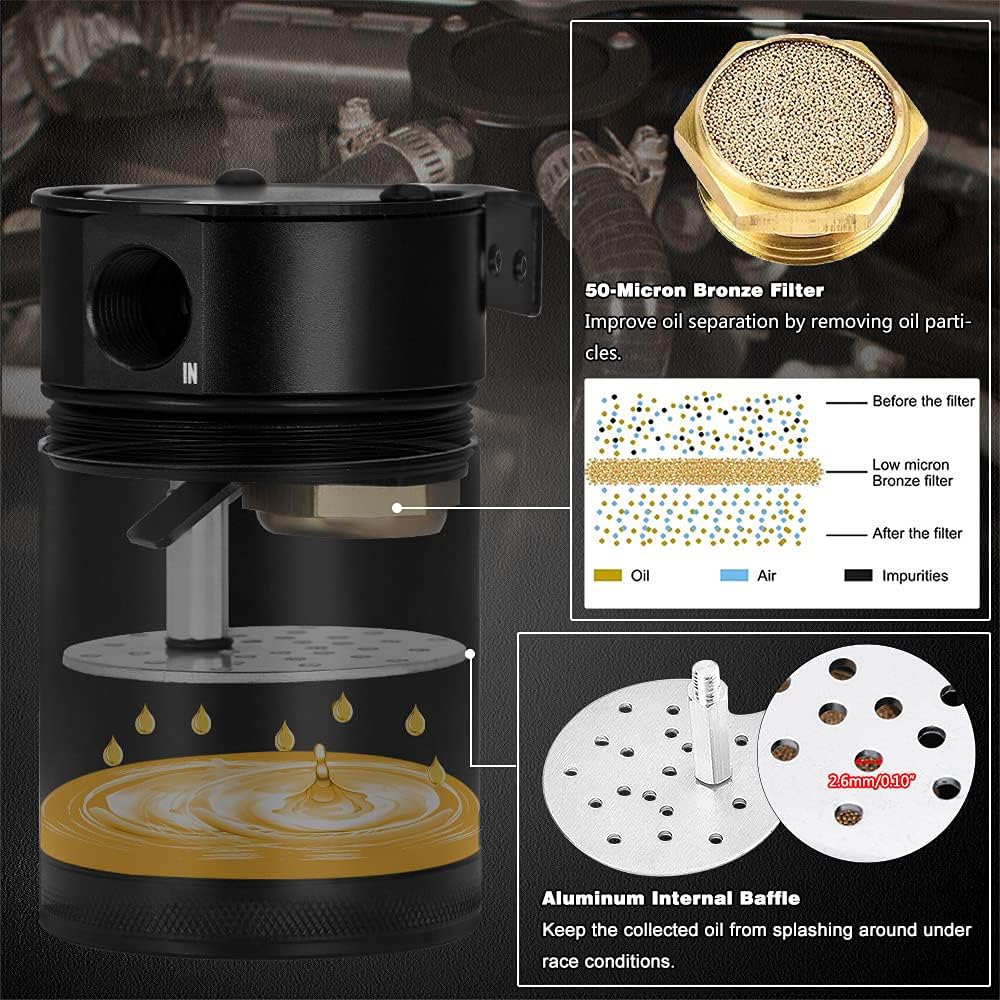

BUT, the other side of me says to "do it," at least for preventative maintenance, and maybe add an oil catch can, too (if those things really work, and the reason I started to get into the PCV research).

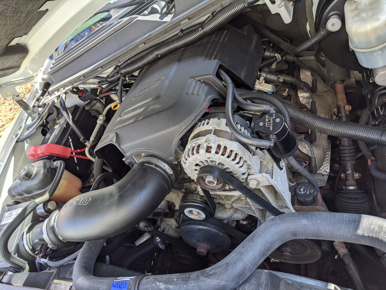

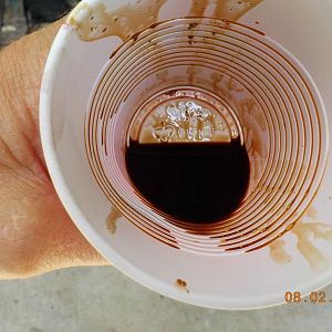

Yay! You're already aware of the need for a catch can. They've been shown time and again to be beneficial on these engines. It seems the only ones that have negative experiences are those in climates that allow the catch can to be flooded with water from condensation. I'm in the Gulf south and mine has straight oil in it. I consistently catch 2-3 ounces every 5,000 miles. That's 2-3 ounces less puddling in my intake manifold and dripping into the rear cylinders.

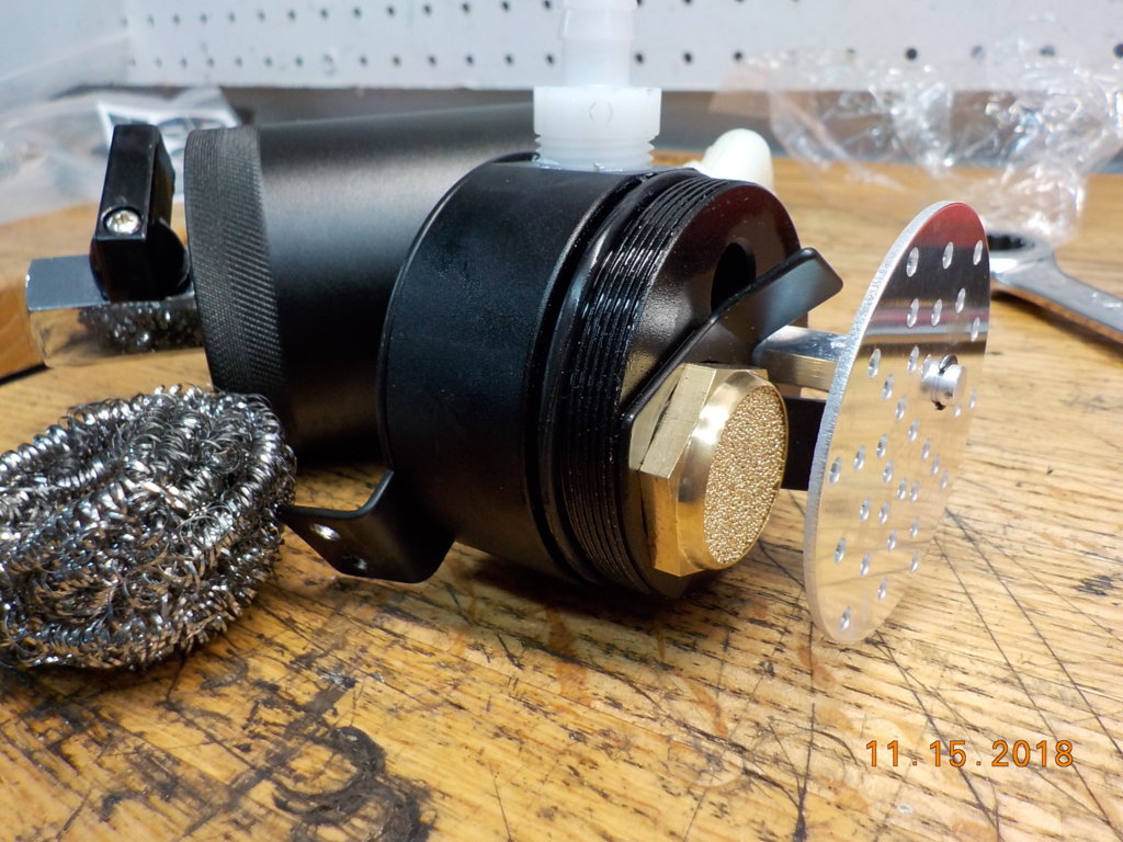

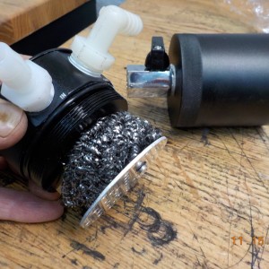

2. Invest the ~$20 in a catch can. Don't forget to add the stainless steel scrubber pad if it's not already included.

I ordered the updated rocker cover and the J&L oil catcher (they have a steel mesh built-in).

what catch can do you have?
I have a catchcans.com one. A little pricey compared to the ones on Amazon and eBay that are functionally the same, just a different shape. I bought it in a group purchase (on another forum) waaay back in 2010-2011 for a project but never used it. I've bought two of the $15-20 ones off Amazon and see equal results as my $100+ one.

Alos, why the steel scrubber pad?
It improves the function of the catch can. I forget the exact amounts, but I consistently drained the same amount of oil from the can at each oil change. After adding the scrub pad, I've consistently drained more, like 1-1.5 ounces more.
