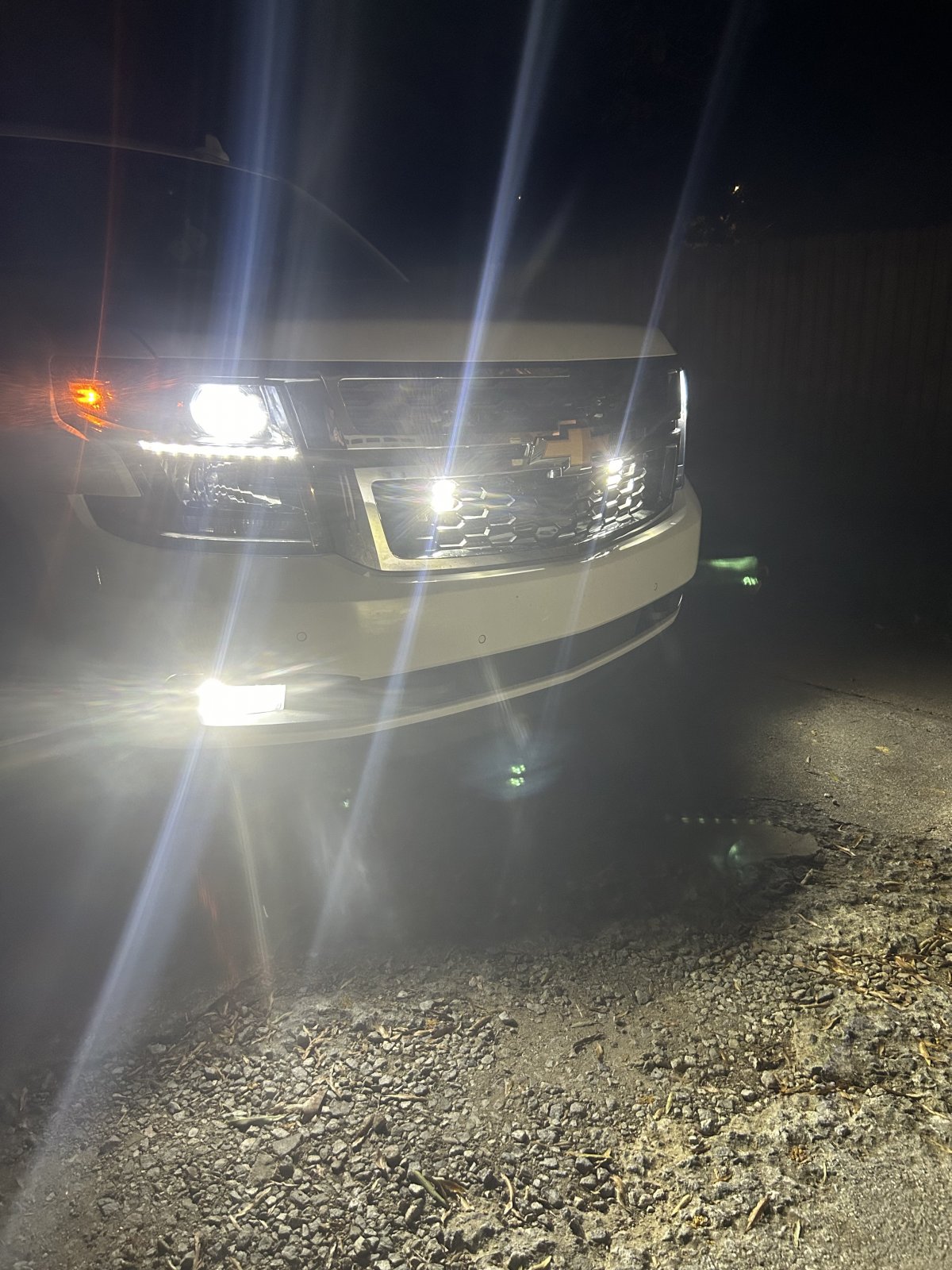

I have these hard wired in now but have killed my battery when i forgot to turn them off. Looking for a good fuse that is dead when the car is off but can power these when on. Either under the hood or right side... who's using what?
My personal opinion is that the installation is very unsuccessful. There will be a strong glare from the hood, and the driver will be self-blinded. As for the connection, I have an LED Bar connected to the high beam via a relay. The power itself is taken from the battery, and the relay turns on the power for the high beam. Plus there is a deactivation button in the cabin. It turns out that I can turn on Far with LedBar together or without LedBar, but I can’t turn on Ledbar separately
