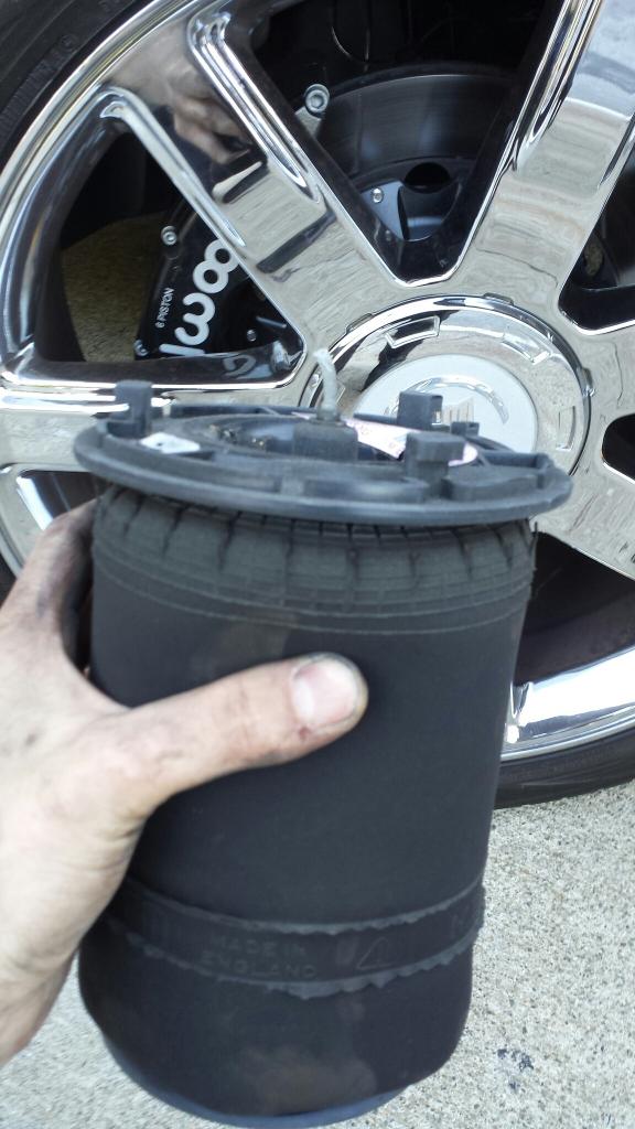

Dropped another customers TBSS today so took some pics to help you guys out.

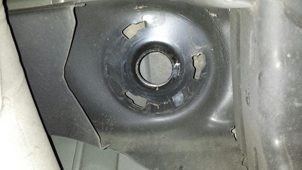

and how the tbss rear top rail looks like to make it work
What i usually do is cut the ears off on the top of the bags so you have 3 straight only tabs going up. you then can notch the cross member and the ears on the bags fits right in and doesnt move.
At ridge height you can adjust it from a 3-4 inch drop then drop it and truck will lay frame on axle.
oh i forgot 1/4 to 5/32 push to connect fitting and then you can hook up a little airlift wireless air compressor to lift it or you can do it manually up to you.
