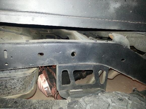

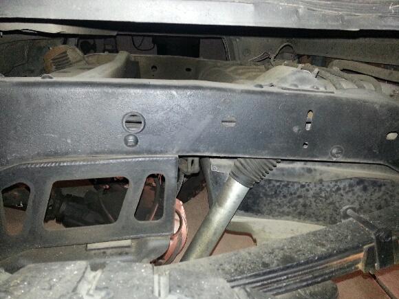

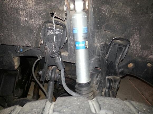

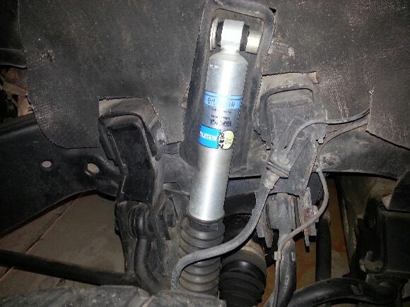

Decided to buy a 2 door tahoe. Never owned a lifted vehicle and have one I am ready to fly out to get. Can you guys look at these pics and see it it looks good? The guy bought is as sits and does not know much about it including how many inches it is lifted

Does it all look ok? What should I know about buying a 2 door and what should I be looking for and why to avoid?

Based off this picture alone I can telly you it is cranked too far and rides horrible. CV boot looks like it is at a hell of an angle and the UCA looks very close to the droop stop. Quality shocks will do nothing if they're stretched out. If the tires are not too big you can hopefully decrank it a bit and save the front end.
attachment.php
Have him get you more pictures of the suspension and I can confirm or take back what I said.

I agree with yates. Those cv boots look awful and will be splitting shortly. I also don't like the way the diff is angled. Imagine how hard it is to get lube to the bearing at the output with it tilted like that. Any pics of the front diff set up? That cheesy looking spacer at the top of the shock looks like hell, also.

The first red flag is that the guy bought it and is now selling it right away. If he had it for a while he would know more about it. He is already having problems with it and wants out from under it and hopes you will be his savior. I would not skip this one, I would run away quickly. It is a mess and will cost you more than it is worth. IMO. If is not what you want then walk away and keep looking. We found problems quickly just in a few pics.
