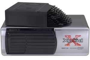

changer controls as the radio can control a separate cp player that holds multiple disc and mounts away somewhere else out of view. it looks something like this.
you can see if they are still made or buy used but they had ones that also had a separate controller that would feed the audio thru a stereo plug or fm radio signal.
Like this: http://www.overstock.com/Electronic...r-CD-Changer-Refurbished/1590568/product.html
6.5"will fit the doors. most don't use or replace the 4x10 in the rear roof. but you might. i think pioneer still makes some but some have fitted 6x9"as well. i have a dual 10" down-fire box under the back seat on mine. plenty of options out there.
