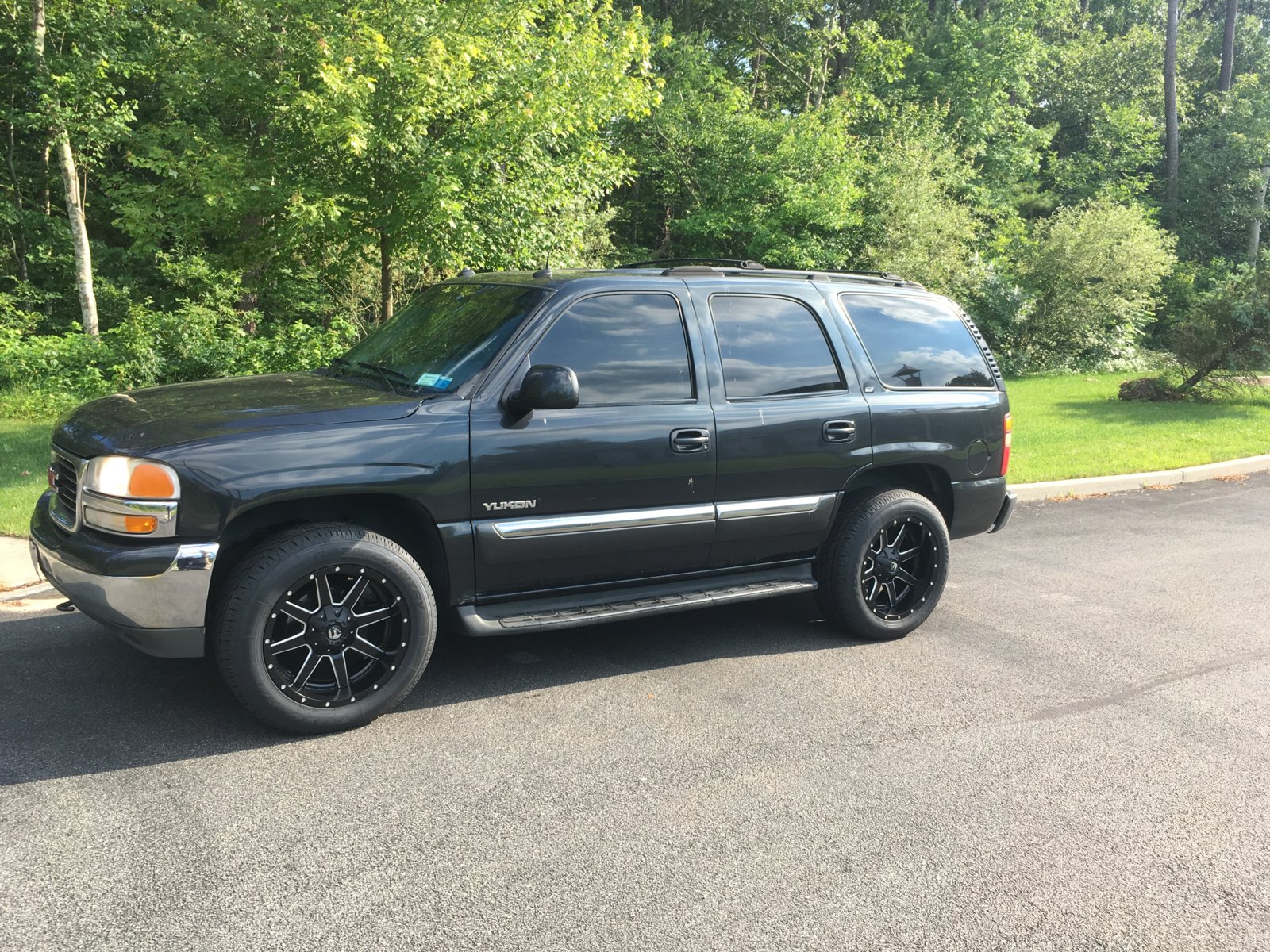

Here's my final setup.
Wheels are Helo 20x9 with +18 offset, Goodyear Duratracs 275/60r20s.
LF 39 1/8"
LR 38 1/4"
RF 38 7/8"
RR 38 7/8"
Thinking of either lowering the front a bit, or putting a 1" or so spacer in the rear. Not sure yet. You really can't tell from eyeballing it that there is a difference, and it drives well, so I'm pretty happy overall.

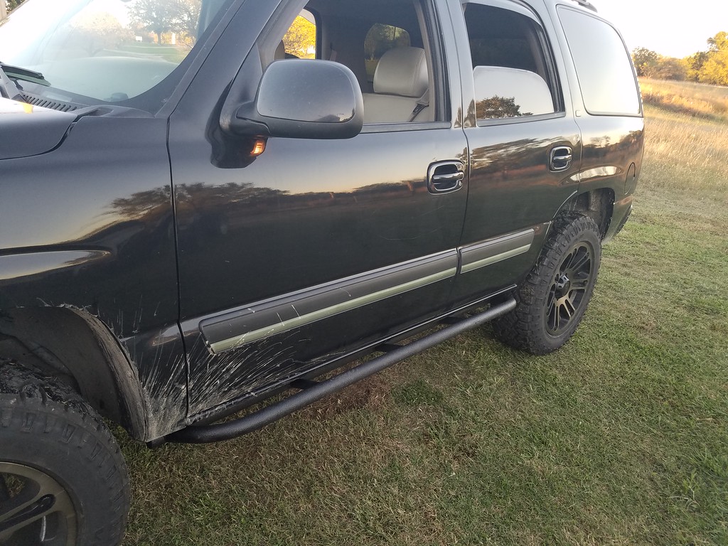

Ever so slightly rubs the inner wheel well liner. Nothing to worry about and I can prob zip tie it totally out of the way but I just haven't done it yet.
