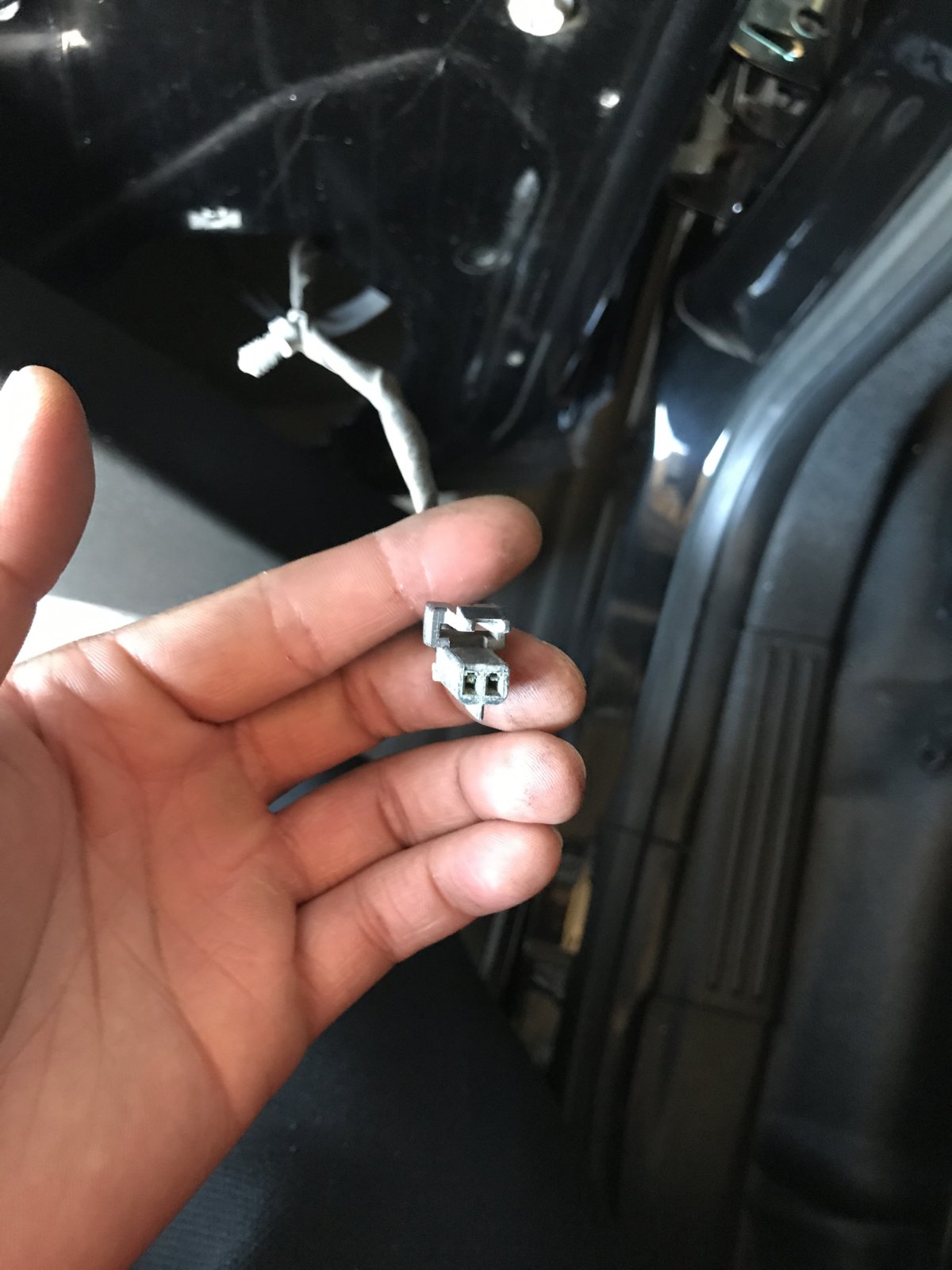

It has a harness, but when i hook it up. No sound.
Harness is old and corroded so that might be the problem

Damn, that's not good. I didn't know they went to that extent, that's ridiculous.
You could try to clean the harness and use some dielectric grease when you hook them back up.
I just had my panel off to replace the window regulator, should've looked mine.

The harness was pretty corroded. Ended up cutting it off cut some of the wire down and just wired directly to the speakers. Got sound so I’m happy for now.
Either the rears don’t get as loud as the front or my mind is playing tricks on me.
