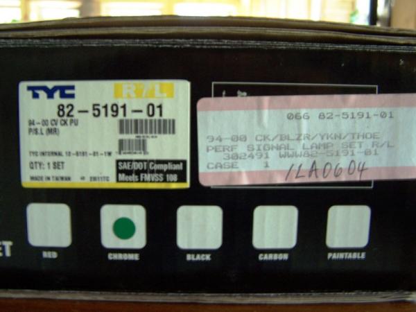

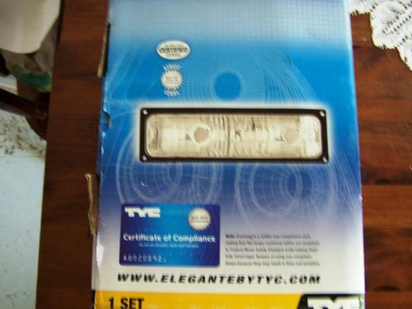

If it helps, my complete set were part# 82-5191-01. That PN was for the pair of bumper lights. I think the thing that nobody talks about is the color of the trim ring around the lens. Try to pick out a trim ring color that matches your truck. Although I think I've only ever seen black or chrome.

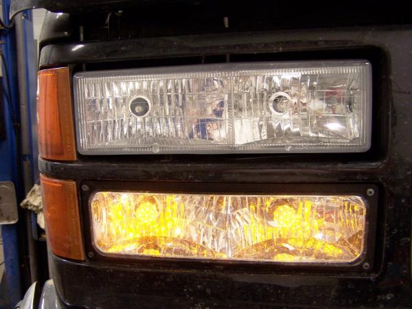

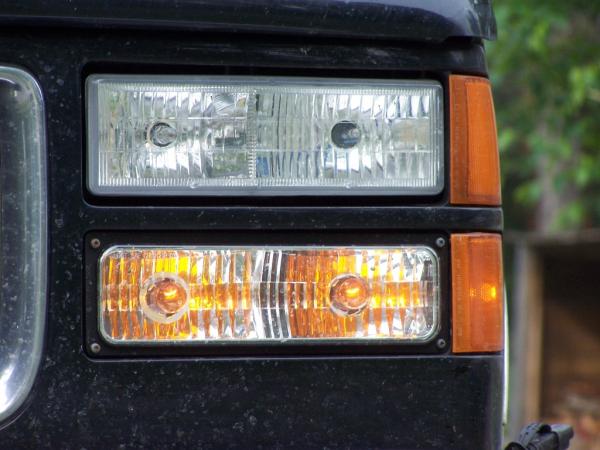

When you get your clear bumper lens, consider dropping in some LED bulbs. I got four of these bulbs from Hong Kong delivered for $20.
Here's what they look like with old amber bulbs;
Here's what they look like with the LED bulbs;
