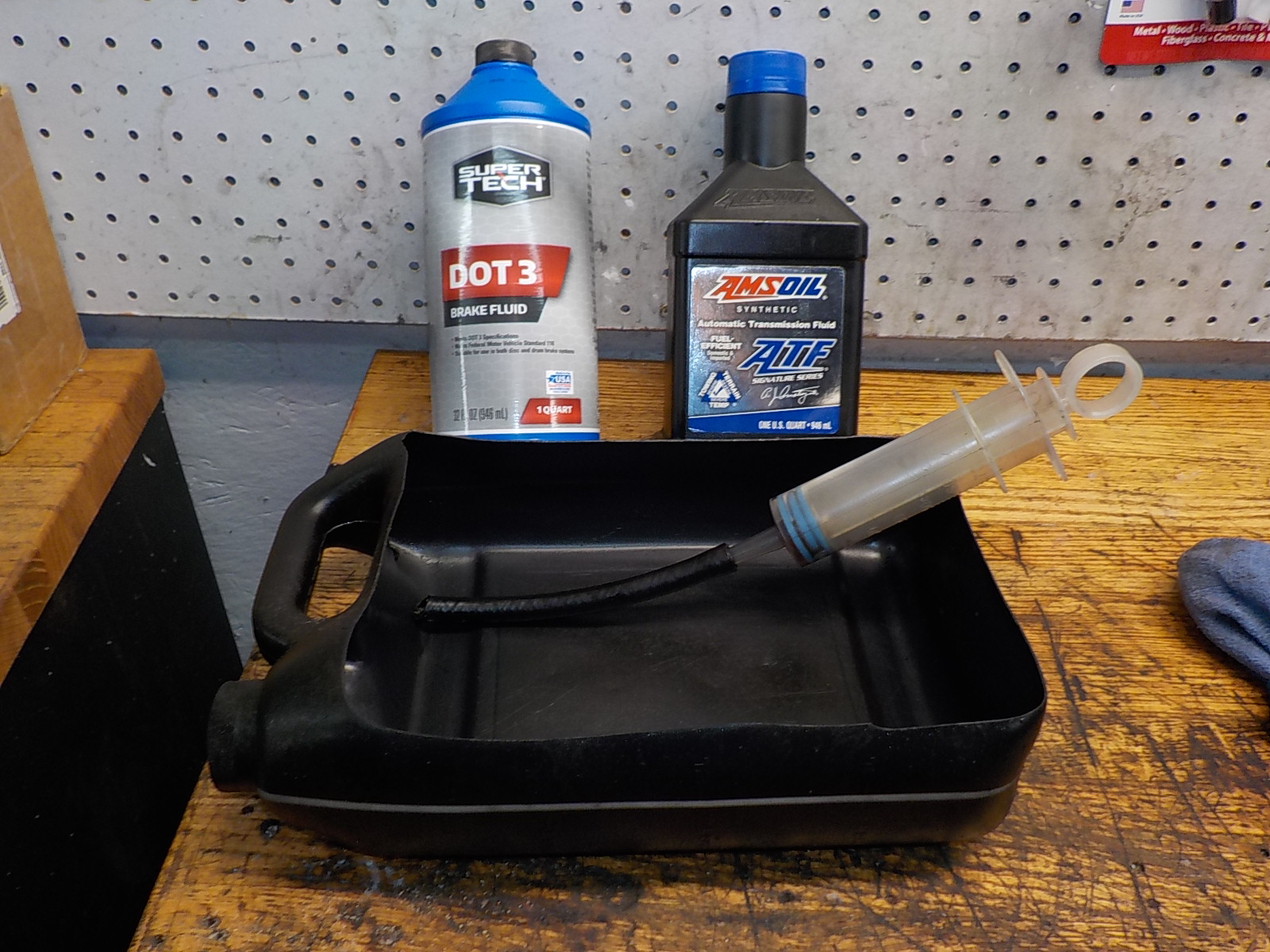

For the last 50 yrs I've used atf for ps fluid in everything I have owned. No issues.
For the last 15 yrs I've used synthetic Amsoil atf for ps fluid in everything. No issues.
I too have done this and seen many other do it. It definitely works just fine. I'd be curious to see what the differences really are between the two. It seems as if the PS might be a little thicker, but not by much.
