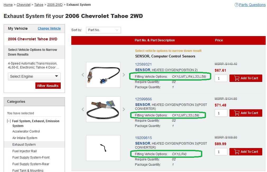

I'm getting some O2 sensor P codes showing up so I'm looking at installing new.
RockAuto is confusing because it lists "Downstream" for pn 2133533 but that is an upstream sensor. Does anyone else see this?
Also, speaking of trying to buy GM OEM - if it says GM on RockAuto is that as good as buying at the dealer?
Fless
Super Moderator
Apr 2, 2017
11,813
24,033
Elev 5,280
If the part is listed as "Genuine GM" on the RA site, it's THE GM part. I see two different styles of connectors for the O2 sensors, so you may need to look at what your truck has for connectors.
When you're looking at the RA parts, look at the specific INFO for the part and it will list some alternate part numbers:
If you use the gmpartsgiant site and enter your VIN, you can find OE part numbers there to match up with the RA alternate numbers. Here's what's shown for a 2006 Tahoe (you'll need to know which engine you have: LM7, L59, etc.):
