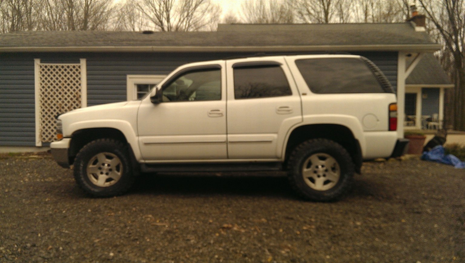

62
Texas
Buy keys and spacers off Amazon or eBay. I'm running 3" front and 1" rear and clear 285/70/17 with plenty of room. Will either be going to 295/70/17 or adding a body lift for 35" soon.
