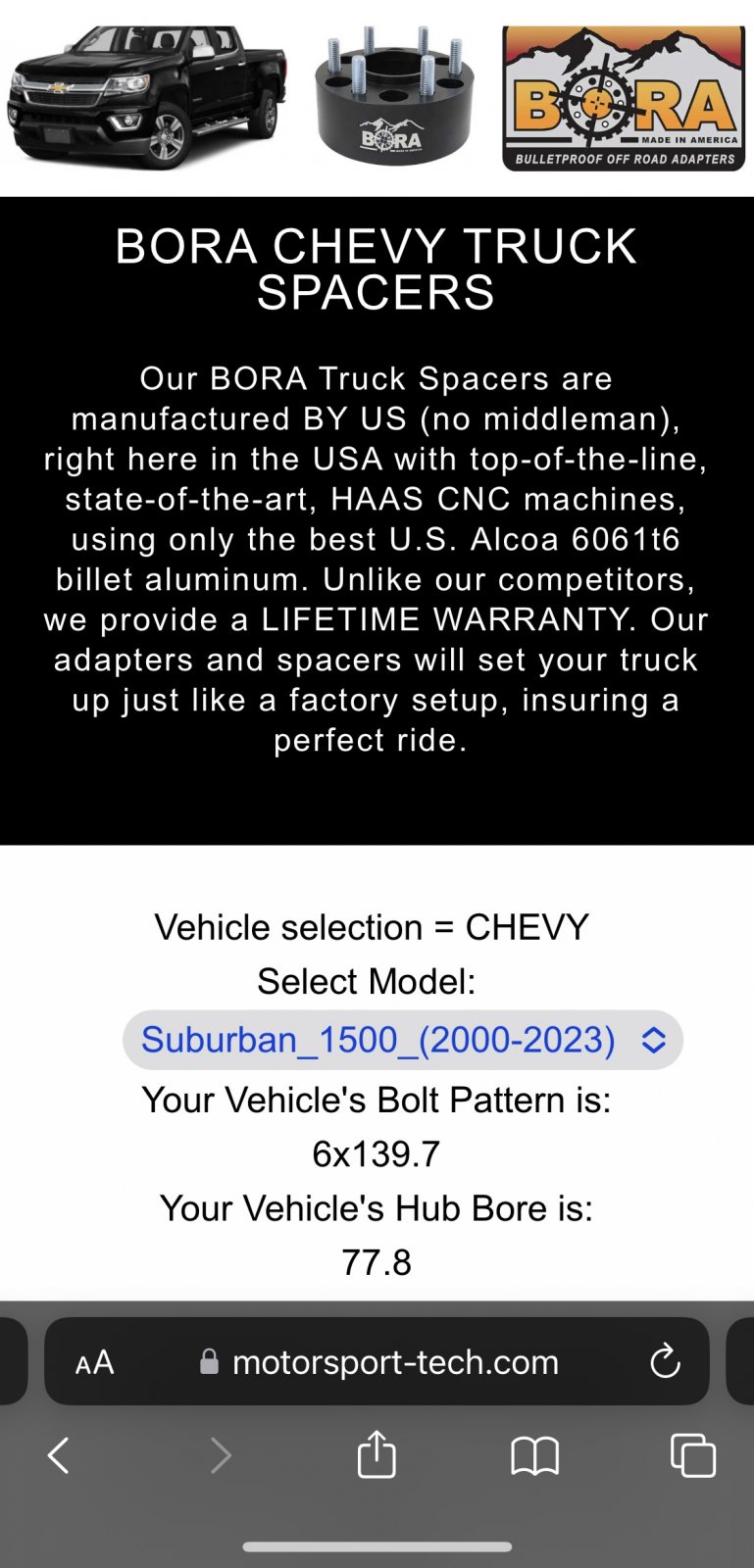

Weird… When I check the BORA wheel spacer site, it shows the center bore size for GM as 77.8 (same as Dodge Ram),
However, when I check everywhere else… It shows up as 78.3.
Which is it?

Hey btw, just spoke to Lenny from Motorsport-tech.com (they make Bora spacers for 30yrs and measure everything precisely). He said that although the specs all over the Internet do say 78.1 or 78.3, if you use a micrometer to measure the actual GM hubs… They are exactly 77.8! o_O
Apparently most online sites simply upload data sets when making these databases, which creates and echo chamber, sometimes resulting in proliferation of inaccuracy.
This all makes sense since my blasphemous Ram wheels are literally spec’d at 77.8, and fit my GM hubs like a glove… Perfectly tight. And come to think of it, likely wouldn’t even fit at all if the hub was indeed .5mm too big.

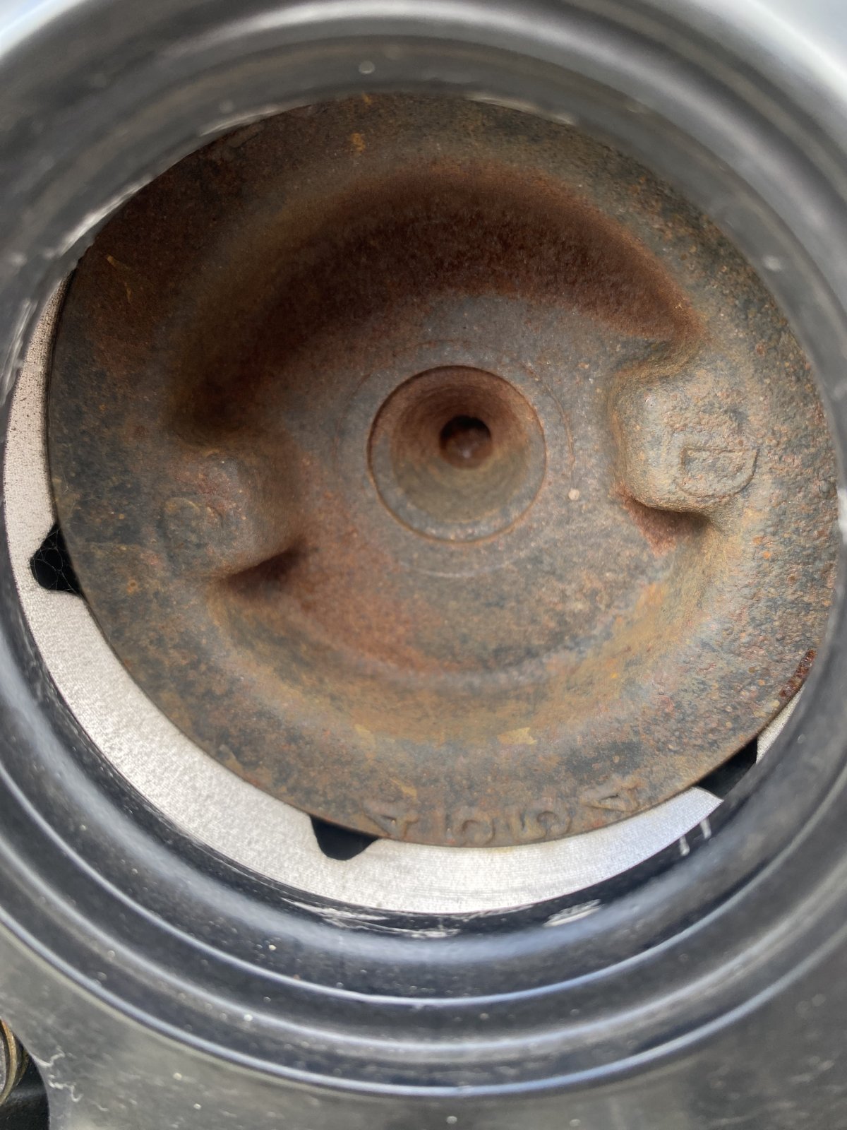

Just measured the hub on an axle in the garage, it's kind of rusty, 78.3! LOL Only measured from one direction and had to go and get the dogs.
