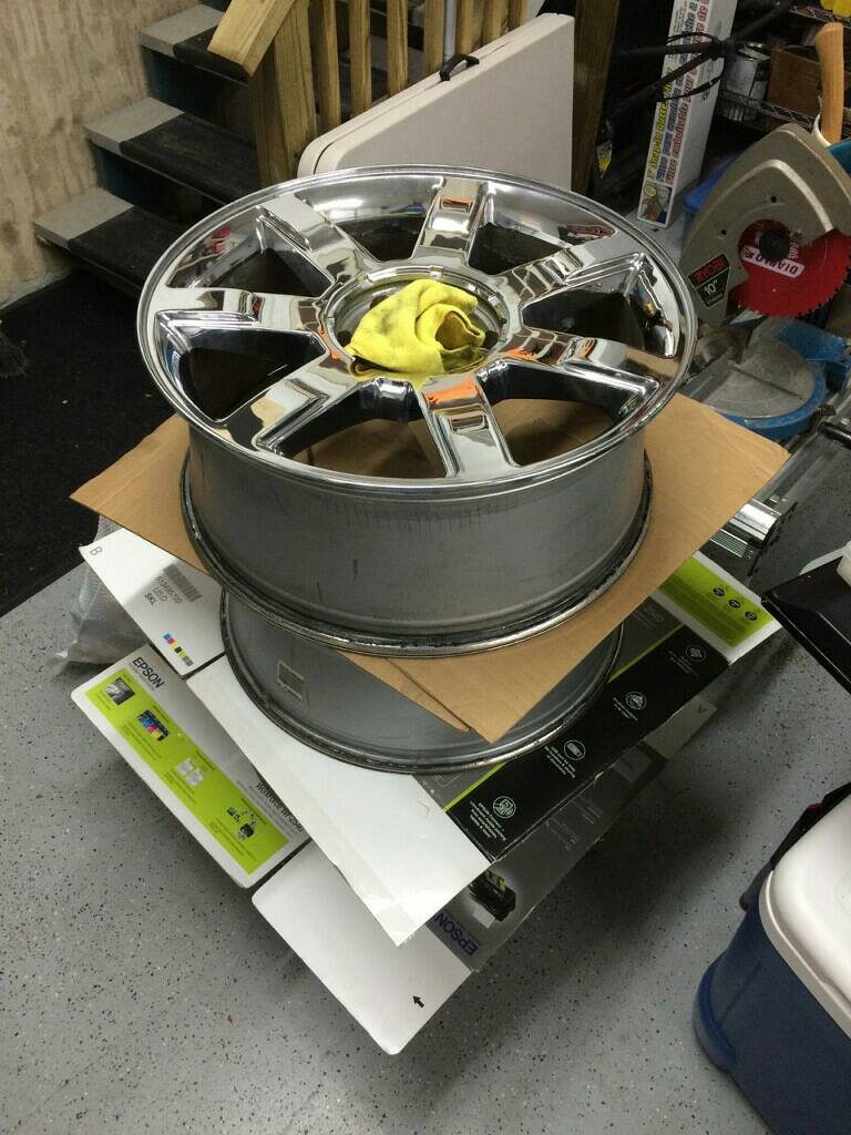

Ok so I have a buddy who is selling me a set of oem 22's for a steal.
But they don't have tires. So I just bought brand new michelins for the 17s when I bought the truck. So I need a good but not crazy expensive set of 22's.
Also since I have a 2004 Burban Z71. I was wondering what size brake rotors and calipers came on mine and are there any direct swaps from other vehicles that would help with the 22's? Was looking at big brake kits but 2000 for the front and the same for the rear is completely out of my league. I was hoping to find something at a pick and pull junk yard. Any help from everyone would be great.

good luck, those wheels looks super fresh!!

They do look nice that's why I was thinking the stock 45 series tire doesn't look bad and will give more cushion. That's good to know about those Toyo tires I saw a set the other night and was thinking. But what did the Baer set of brakes run ya?
