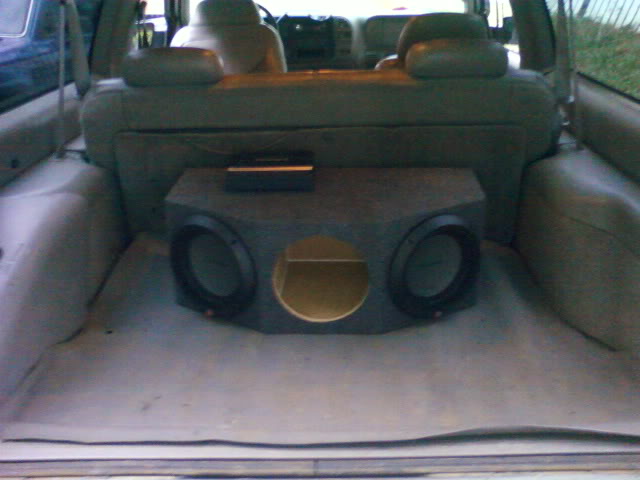

so i have 2 rockford fosgate p1 10s, 4 ohm....im adding another and i have a 2 channel rockford amp that wont push 3 subs...what amp should i get?...im not an expert on car audio but i believe it has to be 1 ohm capable... nothin ridiculous but i also wanna push em pretty good...what amp should i get?
any input is appeciated, thanks
what i have now

here ya go, final impedance is around 1.34 ohms. so yes, any 1 ohm stable amp will suffice. The brand and prices are endless.
Are you wanting to stick with a particular brand? Stay with RF? What's your price range and maybe we can help.
here is RF's wiring diagram for you, when you get the third driver.

thanks, the price range is prolly around 200 bucks...brands: any brand worth a damn ha, not like boss or somethin never heard of...
