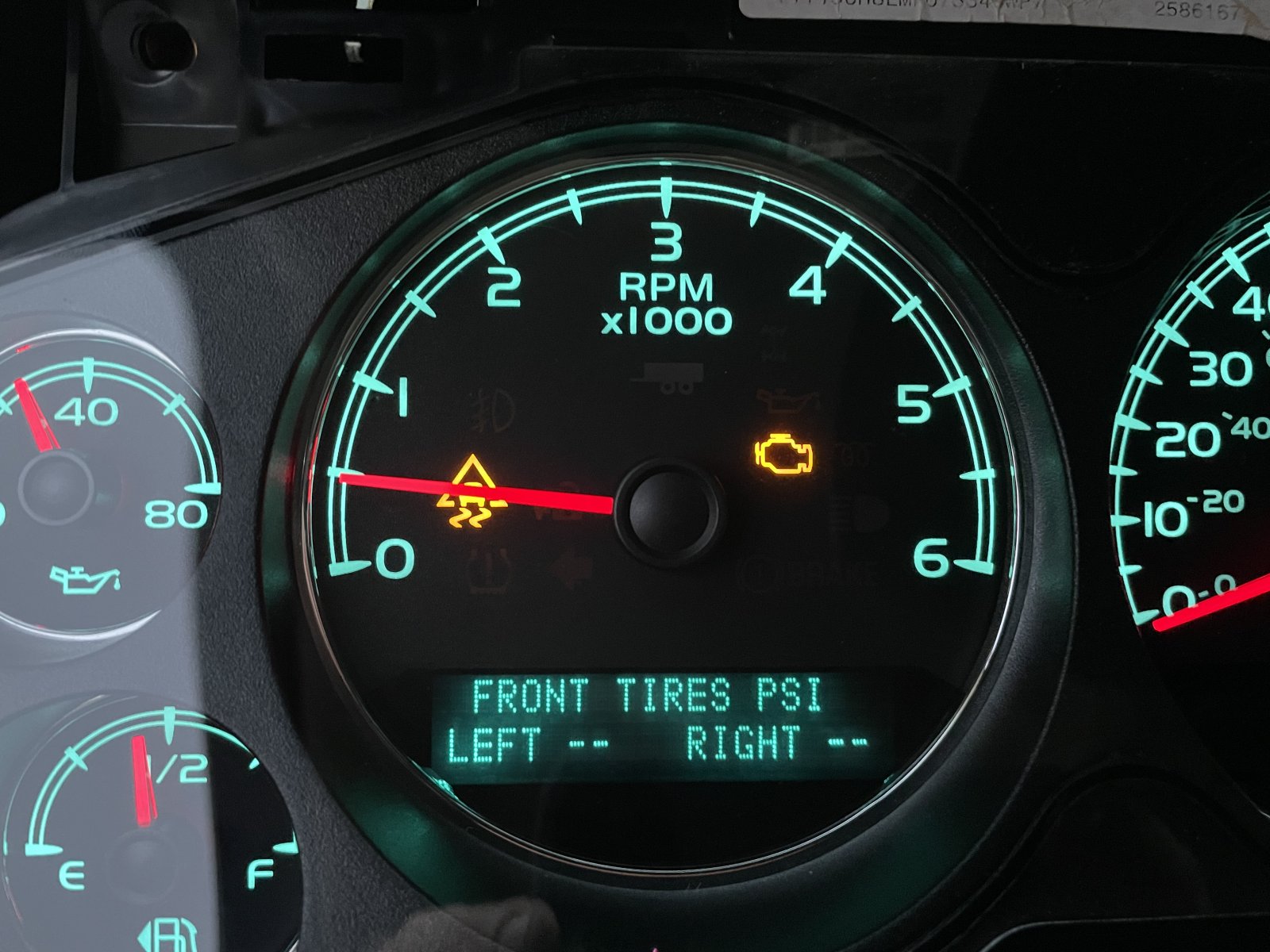

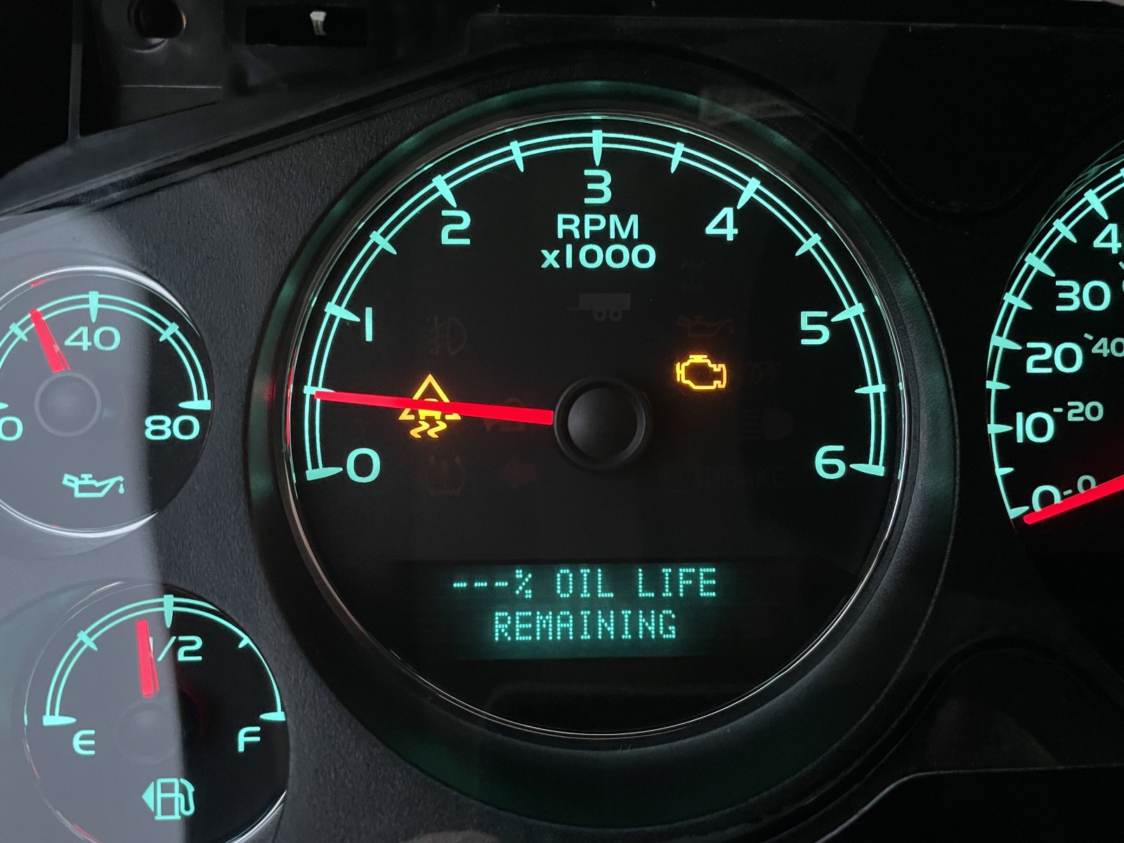

Hey all, may be this is just not a common problem (would be a first on this truck) but I wanted to post a couple of pics of what I see on both clusters. If anyone has any thoughts or recommendations on what could be causing this, please let me know. I really assumed this problem was isolated to the older "replacement" cluster I've had in the truck for a few years now. I was not expecting this new "used" cluster to exhibit the same problem.
Also reading other posts I realize I may not have posted much information on the truck itself yet. Its a 2007 Tahoe LTZ with the 5.3l Flex V8. Highly optioned. No real modifications other than some exhaust work to install a nicer muffler for better sound and more airflow. Not a cat-back system, no headers. I recently had to have the transmission rebuilt. I'm in a local car club here in my area and I went through a guy in the club first. He attempted to rebuild the trans but it had more problems after and he attempted to diagnose those as well but ultimately I had to take it to a trans shop. One if his recommendations was to replace the ECM. That was $175 wasted as it did not help with the trans shifting problems at all. So the ECM has been swapped out with an ebay unit re-programmed with my VIN, BUT, I need to mention this issue with the gauges existed for years before the ECM was changed so I dont think that has any bearing. I have never replaced the oil sending unit but the gauges worked fine before the cluster swap. I am also running stock tire size (all 4 are new within a year) on aftermarket 20" rims but those rims were also installed long before the cluster was replaced and all the TPMS sensors worked fine (with the aftermarket rims) before the cluster swap.

So update. Turns out the TPMS was just on me. All I needed to do was go through the re-learn procedure <smacks forehead>. Don't know why I never considered that before but glad I got it working again. So with the new "used" cluster that has the option back again to learn new remotes and the TPMS sensors now working I just have to figure out why the oil lifetime percentage is not working.
There are likely dozens of these articles but this is the one I used to have the truck "re-learn" the tpms sensors:

Did you try resetting the oil life monitor by holding down the bottom button for a few seconds? Maybe like the TPMS it just needs to be reset
I did. I wish it were that easy. I think @swathdiver may be right. Its not that it needs to be reset from something <10% back to 100% which is the normal reset , its not taking a reading at all. So its possible something has to be re-programmed. I'm having the new "used" cluster repaired later today and will then take the truck to the dealership.
Unless anyone in the San Antonio area has a Tech-2? Guess I need to go read that thread.

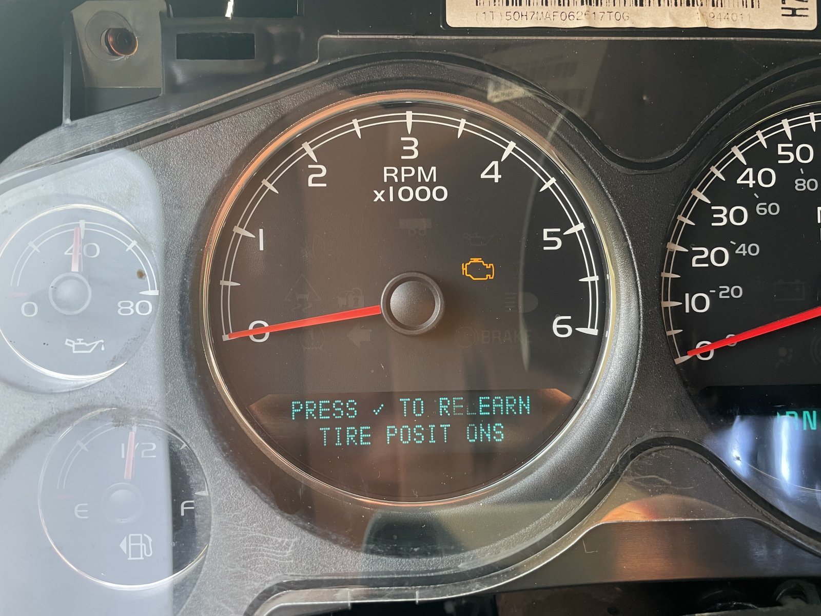

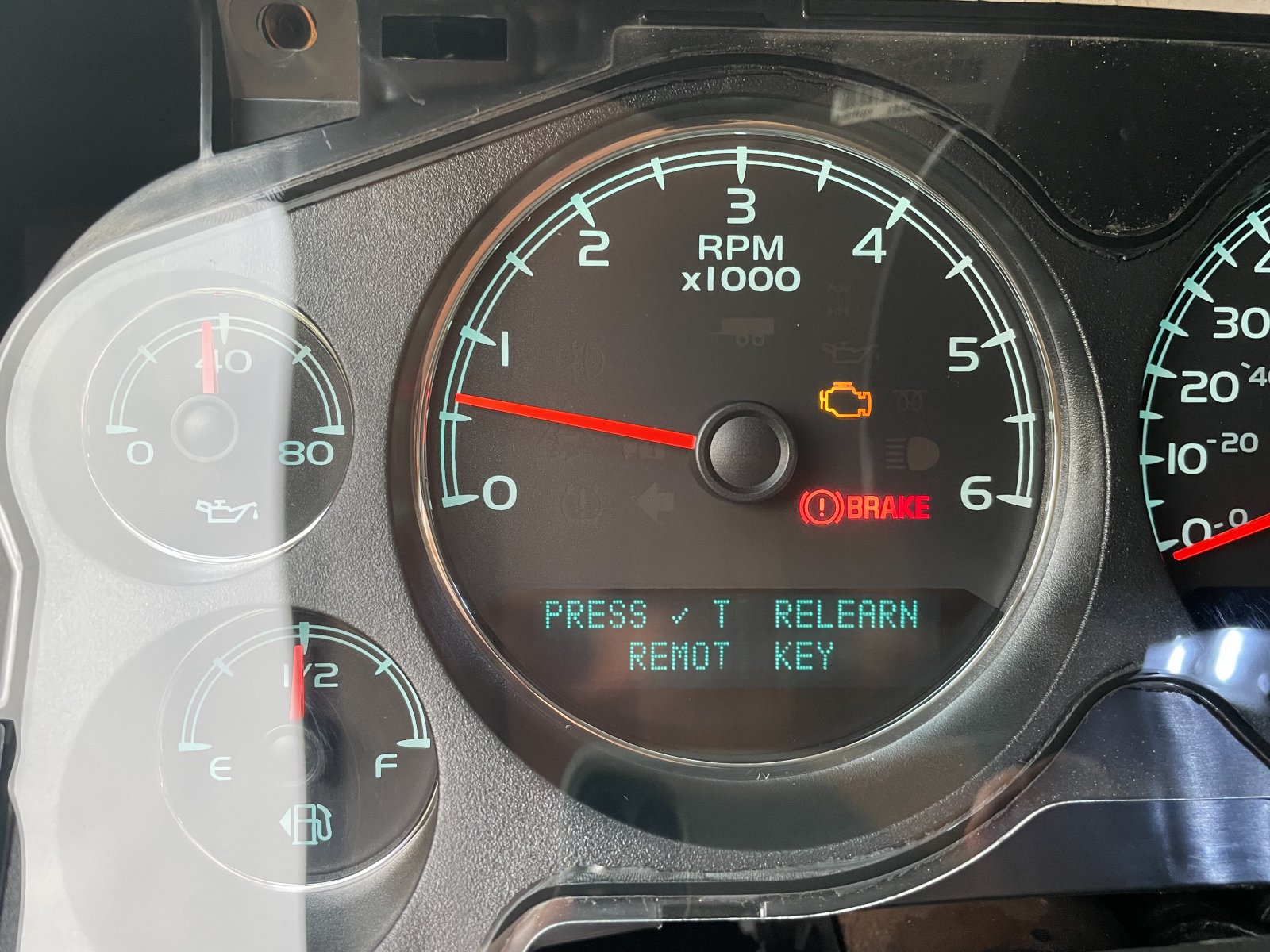

By the way, also wanted to post these pics with more information on the different options seen on the different clusters. Would sure like to better understand when/where these options come into play.
Current used cluster: P/N 15944011 (1st pic with option to re-learn tire positions)
New use cluster: P/N 25861675 (2nd pic with option to re-learn new remotes)
Both options are in the same menu slot.

swathdiver
May 18, 2017
19,582
26,267
Treasure Coast, Florida
There is a thread on this forum of where guys live who have a Tech-2. DIC menu options can also change when GM Accessories are programmed into the vehicle such as the Tilt and Shock Sensors or 2-Way Advanced Remote Start.
