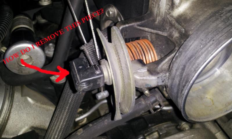

I just received my new AC Delco throttle body from rockauto.com ($106 and surprisingly it included a new IAC and TPS). It has the metal piece for the cruise control's plastic part to fit on; however, I can't figure out how to remove the plastic piece for the cruise control from the old TB. Suggestions?

There is a little clip that comes out if I'm not mistaken. Close to the metal part it attaches to. But do it off the truck so it can't fall and get lost.

Yep...it was a small plastic clip that I feared would break but fortunately it didn't. However, I replaced the MAP as well and when installing the sight shield I heard a nice pop when "slightly" tightening one of the two screws and now it won't back out or tighten. I guess I'll worry about that later.
