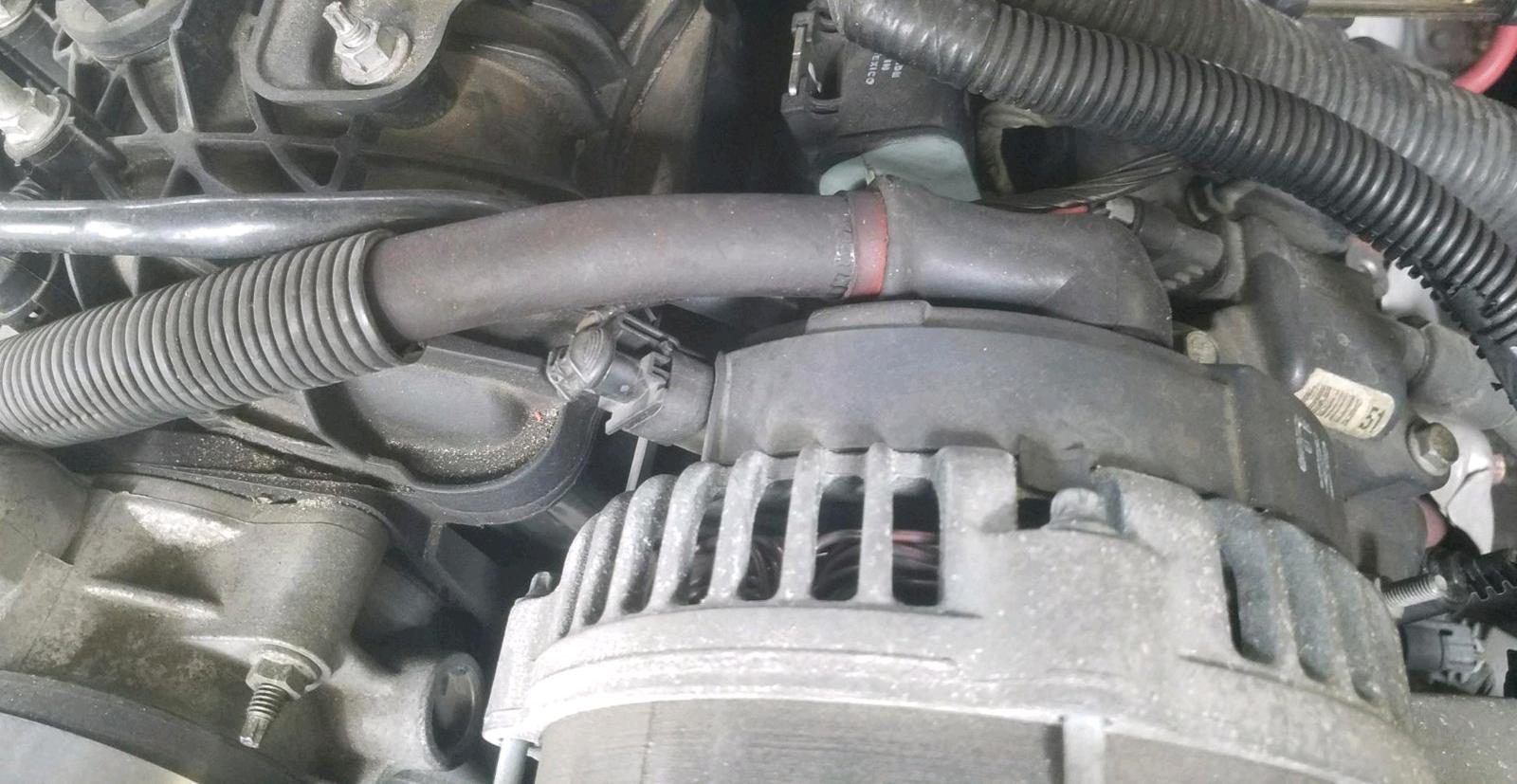

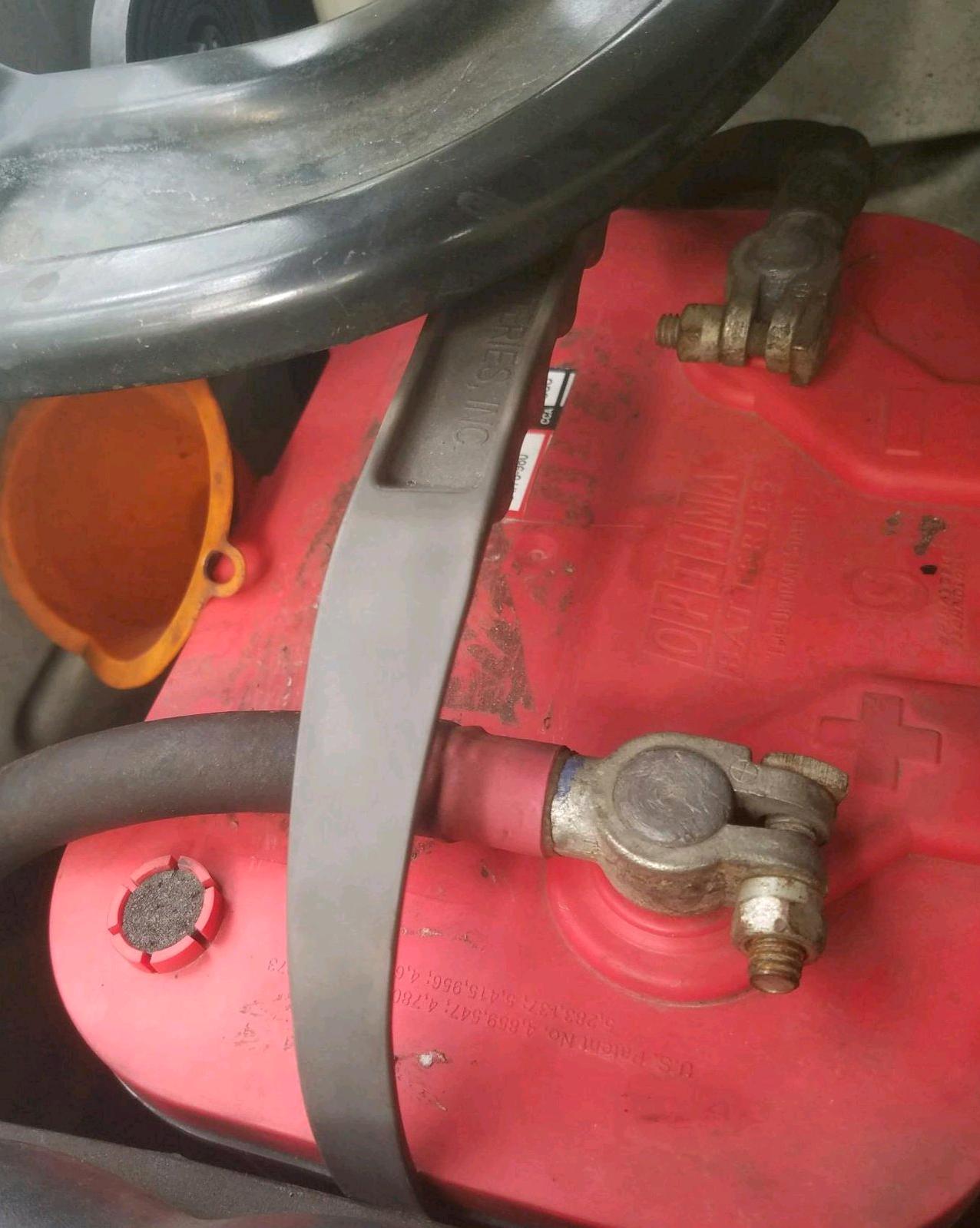

I upgraded my '08 Burb to 2/0 marine grade tinned copper shielded wire and soldered on my own lugs and used marine grade self adhesive heat shrink.
rps20200329_195031.jpg rps20200329_195107_290.jpg rps20200329_195153_077.jpg rps20200329_195227_457.jpg
You can see that the 2/0 wire barely fits inside the ground wire amperage sensor.
