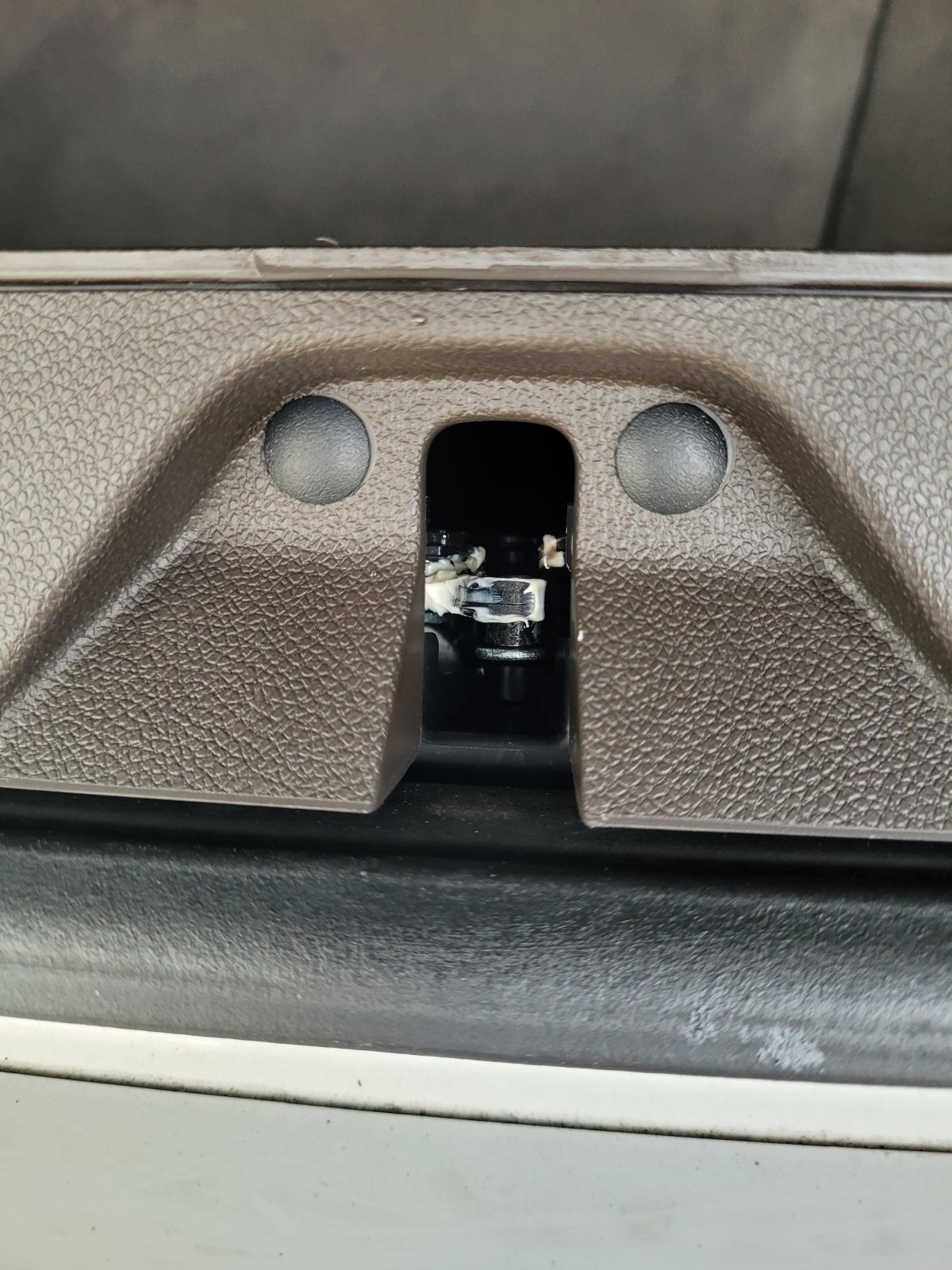

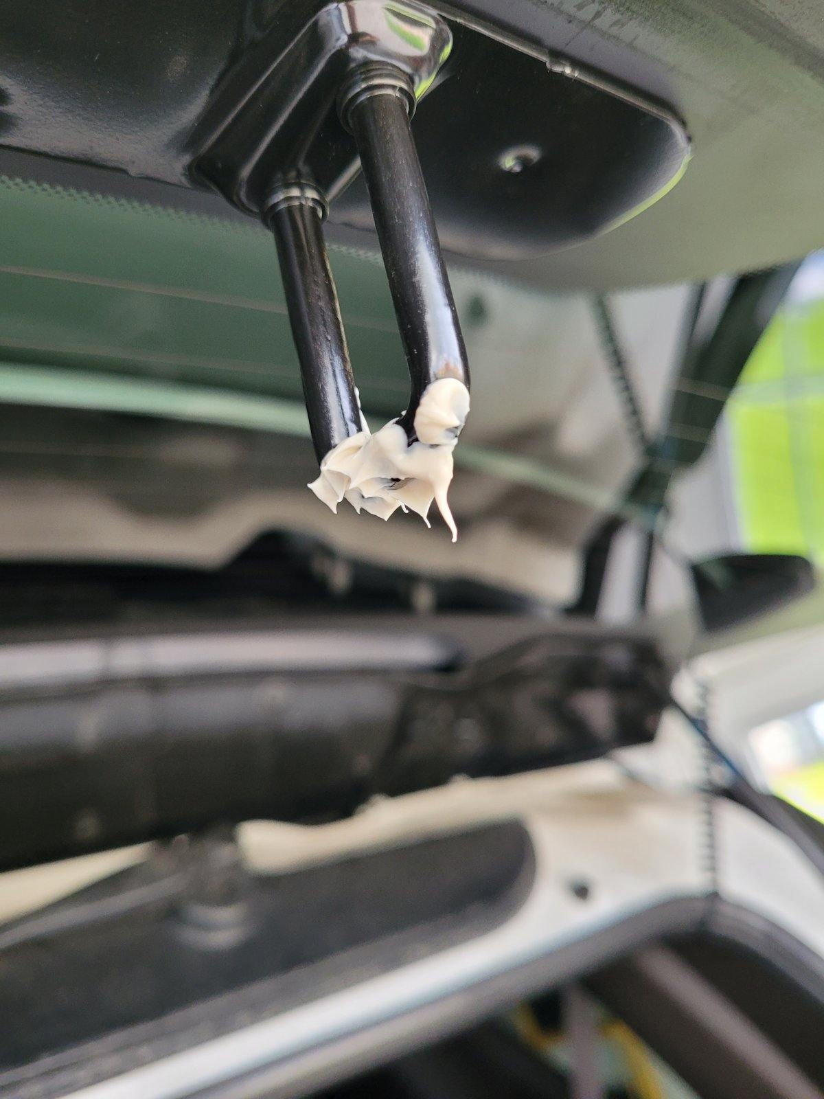

I've fixed so many rattles that I've lost count. It's pretty darn quiet now.
For the rear hatch glass; I added white lithium grease to the latch and its perfect now. Dealer could not figure it out because the rubbing/rattle was coming from this latch and radiating up the glass. It sounded as if it were coming from the rear spoiler on top.
