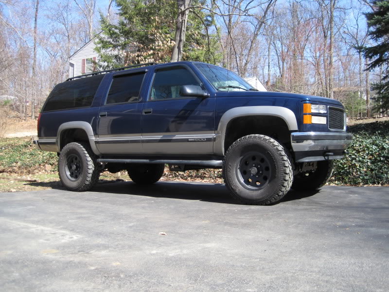

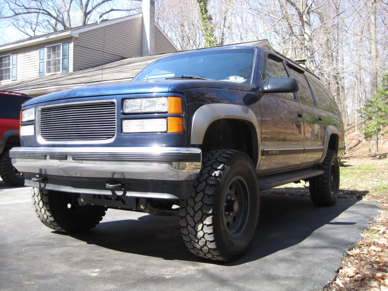

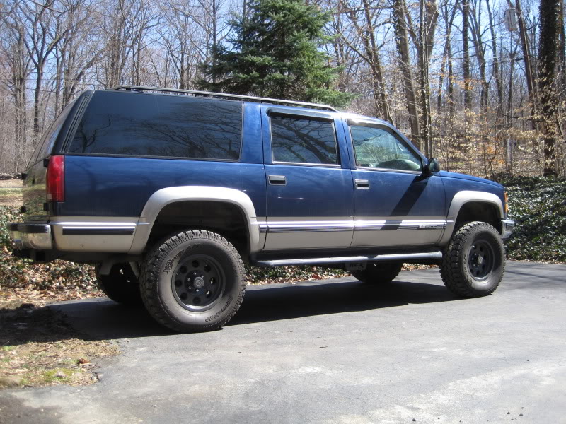

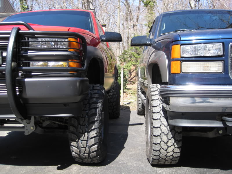

RCX is a nice kit, I run it on my suburban. the difference from the 4 to 6" kit is nothing more than the AAL. The kit even came with the longer rubber front brake lines. The kit drops the differential down about 5.25". I have been very happy with the kit, been running it for a few months now. The tahoe runs a DC lift or extremem suspensions kit....a taller 6" lift.
Lift springs are great for the back but will stiffen the ride over using just a block. A block literally just lowers teh axle and doesn't effect ride quality like a new spring. I run 6" springs on the tahoe and teh ride is stiffer. With that all said big blocks are never a great idea but they serve a purpose.
If you have more questions let me know. here are a few pictures of the suburban set around 5.5" of front lift. it is running a 35x12.5x17.

Did you have any rub with those tires? What size are they? What about specs on the rims? Thanks man! Is there a way to just get 5" blocks with the kit?
bowtiefreak
No Quarter
Apr 30, 2009
5,404
100
Near Philly
the tires are 35x12.5x17 on a 17x8 ATX mojave with 4.5" BS. Yeah they rubbed a little so I trimmed the back part of the wheel well. I rub on the tahoe which is more than 3" taller. normal driving I do not rub on either though. not sure about a 5" block. I would not do that, use the AAL
