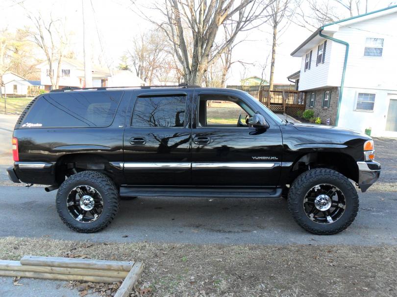

most knuckles need atleast a 17" which means you should go bigger on the brakes while everything is apart.. i have herd of this company and people like the lift but dont know about the durability.. i say get it and throw it on and 35s and call it a day... mine on 35s is DD with 6"

If you have impact gun and air ratchet.. you can do it in a saturday as long as non of the bolts are locked up.. then id say it may run into sunday. its a fairly cut and dry install.. replace this with that... etc.. if you have basics mechanical skills. you should not have too hard of a time... i judge all my projects time by beer intake and id say if you have not dont a full lift before its gonna be a good 10 beer deal..
35 is biggest with out rub.. can do 37s with a 3' body + 6" suspention but that a hole nother basket of issues..
My truck rides smooth as glass down the interstate at 80 mph and 1,800-2,000 rpm all day long.
remember slight trimming of some plastic will be needed to eliminate rubbing at articulation..
EDIT-- the wife is 5' 1" and uses the OH SHit on the dash and the factor running boards and does a little jump.. but she is a gymnest so yea.. watching her mom climb into the rear is well..... hard not to laugh..
i will take pick of my 6' 2" lanky self next to the truck for a compare

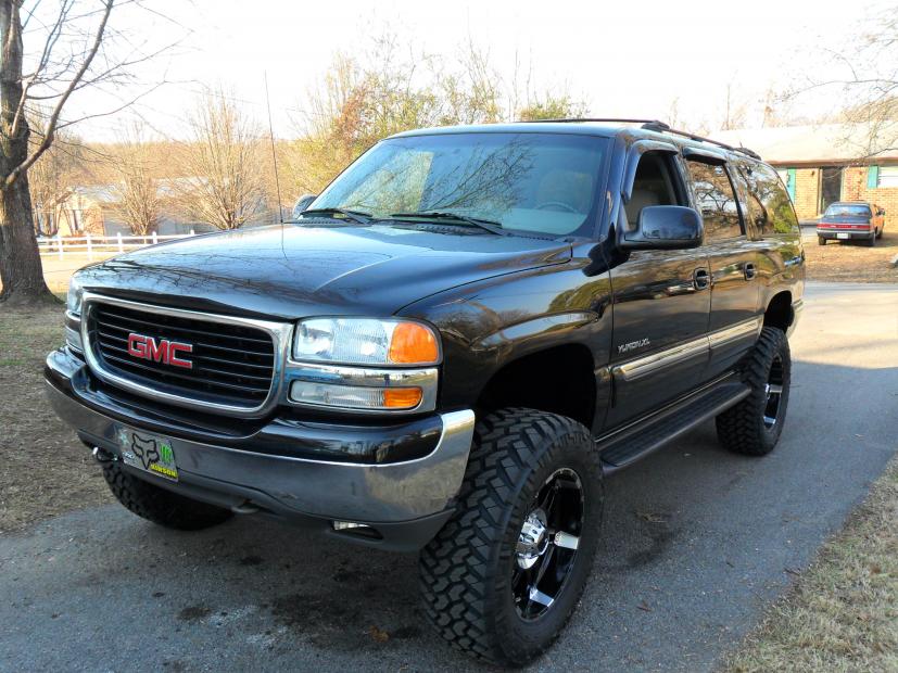

Like the way your Tahoe looks there John.
Ill be going with a RCX lift myself with 18x9 Eagles and 35" Trail Grapplers. Should be done by the summer. Are you running stock gears? How did the MPG change? Im debating between 4.56 or 4.88 gears after the 35" tires.

Arctic-Rodz---THANKS.....Stock gears and the MPG only went down a little. around town im getting 14 with hills.. also i dont drive over 2,000 rpm.. buddy has long headers and no cats. flow master, KN, and a pro tune with custom exhaust mapped to the headers and the intake flow. this tune is very similar to the BB but individual specific mapping for MPG and he gets 19 city and 25 highway at 75 mph and 1,900 rpm.. also 35s and 20s... i am getting ready to do the headers and tune to bump mpg and power..
